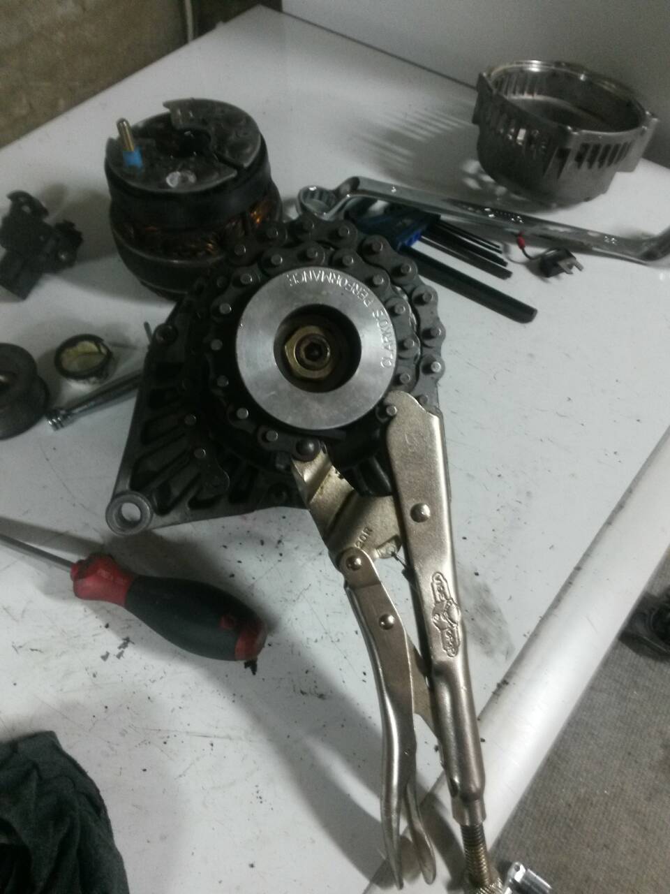

Quick question for you automotive sparkies out there. The alternator on the Calais is dying, I have another but the D+ terminal on the back has snapped off where the condenser is normally connected too. If I'm not mistaken I can just run the condenser straight off the main output post and it should work exactly the same?
- Posts: 3676
- cars: VH, VN, VS, VX
Never mind, turns out the VX alternator doesn't have one fitted. Never did as there was some heat shrink over the terminal.
Had to swap over the rear housing as the spare alternator was from an ecotec. Whilst stripping the old one I think I found the problem (old Vs new)... Whilst I had it apart I also fitted my old 20% UD pulley, All refitted on the car and tested. Happily maintains 14.4 volts at idle at the battery with load. Happy days and only cost me about 2 hours of my time.

Never knew that. Not to bothered, the other alternator was spare (and I got it cheap to begin with), the slip rings on the old one were well worn and the bearings were bit rattly so well due for either a complete overhaul or replacement.
I like those Vise Grip Pliers. I could do with a set up like that.
