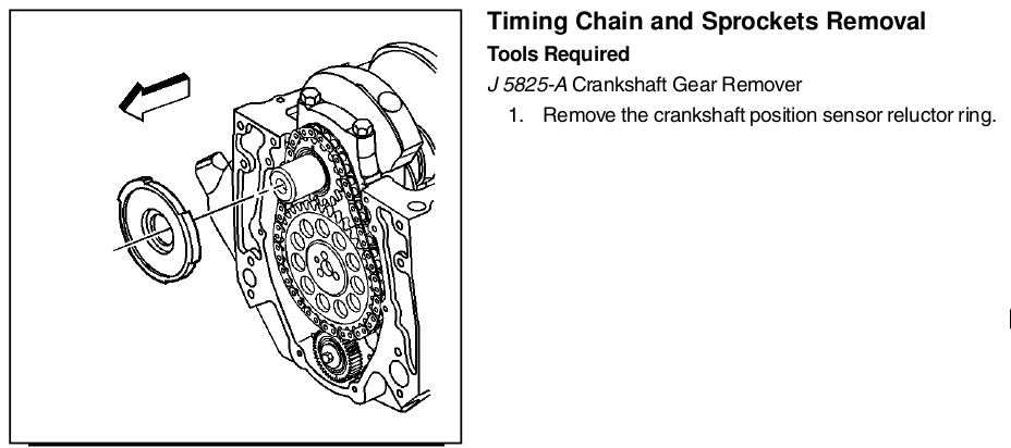

It looks like the position sensor is a reluctor ring shaped like this, with spark delivered through a distributor. There also appears to be a number cylinders scaler in the bin which I'll try and track down.
- GM S10 V6 4.3L reluctor ring.png (42.58 KiB) Viewed 7727 times

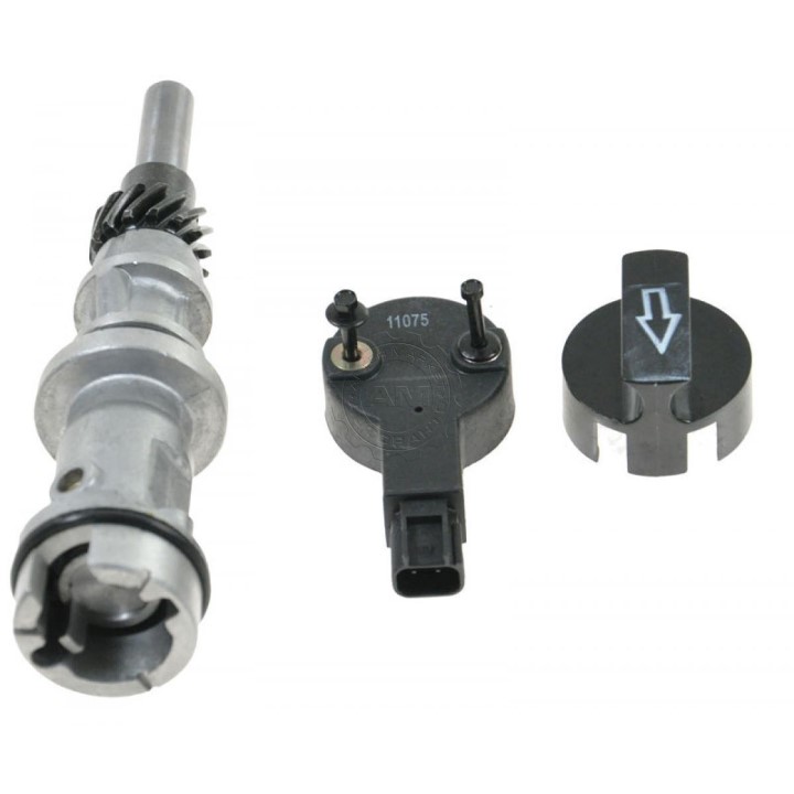

When i first started thinking about putting an 0411 pcm on a 6 cylinder i knew i needed to work out a crank trigger (easy, plenty of options out there) and a cam trigger, which for a straight 6 is less common.
my searches for this showed up ford taurus and falcons as some examples of dizzy cars adapted which used something like this.
this led me to find the right sensor for them and it looked like something i could easily adapt to a electronic dizzy housing, and the sensor was $30 delivered so not too much cost if it didn't work out.

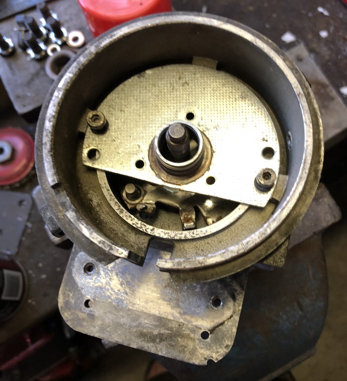

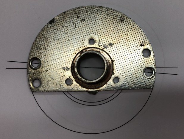

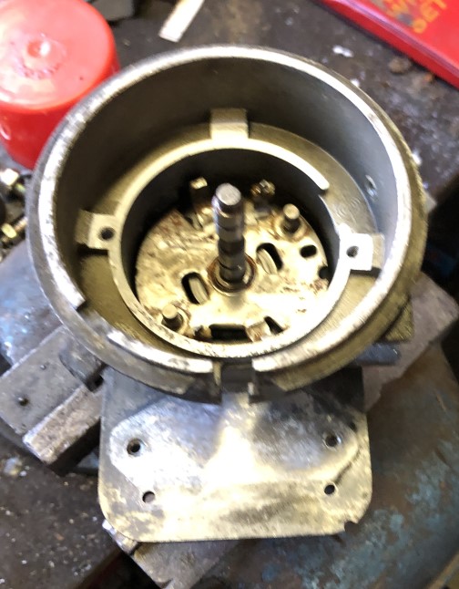

so i found an old fucked dizzy and stripped all the shit out of it to leave the body, main shaft and the reluctor mounting plate.

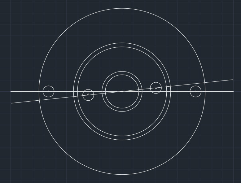

i then mapped out the sensor and the plate in autocad to make a template to lay over the plate to mark for hole drilling.
you can see a second line that doesn't go through the holes, that is the centre line of the sensor bolt holes.
This template will also alow a new piece to be cut from steel if someone so desired.

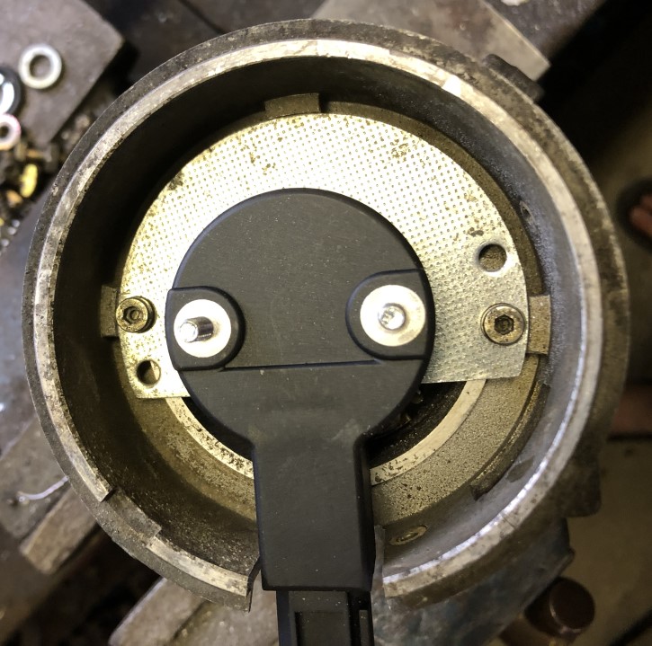

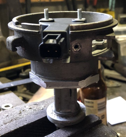

The sensor mounted to the plate, and the hole in the plate has been reamed out to just allow the sensor edge to be level but still keeping some meat for the screws.
I then trimmed the housing hole a bit wider to fit the sensor through, it needs some cleaning up but that can happen after it works

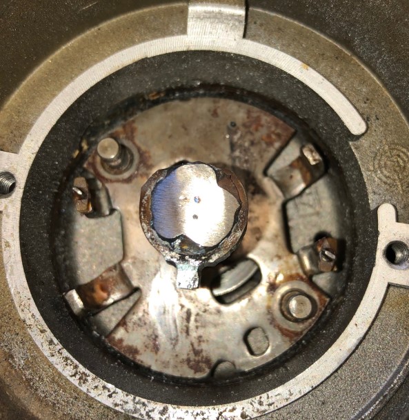

Whats left to do now is to modify the old advance part of the shaft which should work nicely as a chopper wheel for it.

if anyone is interested in this, here is the autocad file.
i printed it at 1:1 scale and it was exact to my needs.
Re: P01 '0411 12200411 v6 support
i have finished making a chopper for it, seems to work on my multimeter which is about as much as i can test it at the moment
