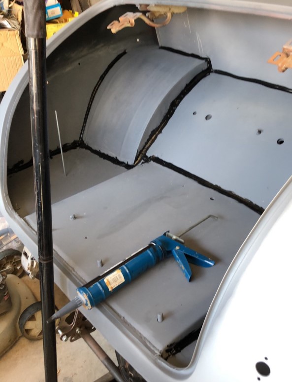

For christmas i got a super cheap auto gift card, so i made use of it by purchasing some automotive seal sealer, gave it a bit of a test run in the boot, geez its messy shit to work with lol

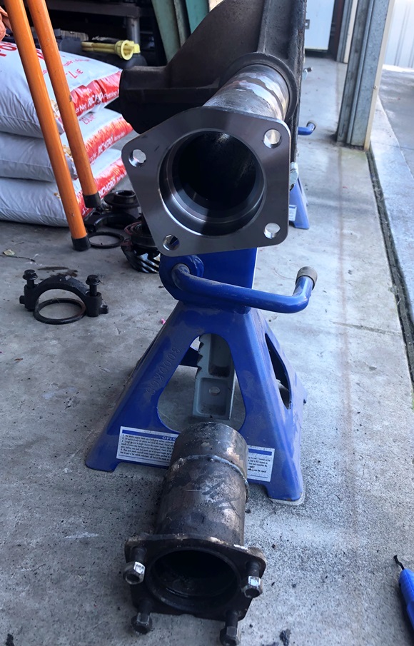

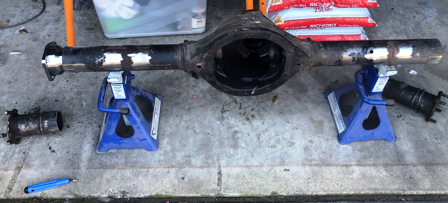

its been a long time coming for this diff, but i have got the money there for axles now and that was the last piece of the puzzle, so i thought i should get stuck into the diff shortening so i could work out when lengths the axles needed to be.
a friend borrowed a diff to use for working out how much to shorten his to fit into a VP so he cut shortrened and welded the ends back on, and once he was finished i got it to use for my setup which is much shorter so there was still enough left on the ends of the diff tubes.
so i spent what seemed like hours cutting all the mounts off and then grinding back what was left. i knew i needed to make it 4 inch narrower each side compared to the diff that was in the car, and i also wanted to get the yoke in the centre of the car, so i measured ten times and i think i finally got all the offsets right, i also had to take into account the approx 35mm for the weld on ends, and had to make sure they had the same depth in the ends for the bearing seats and so on and so forth.
so its finally cut at where i hope is going to be the right lengths, the plan now is to dummy it up in the car with the 4 link plates and weld on ends all tack welded on, just to make sure its actually right before i go and finalise all the welding.
these weld on ends look really nice, and for $90 i think it was, saves alot of time and effort!

Looks good, what size axles, 28, 31 or bigger?
31 spline.
