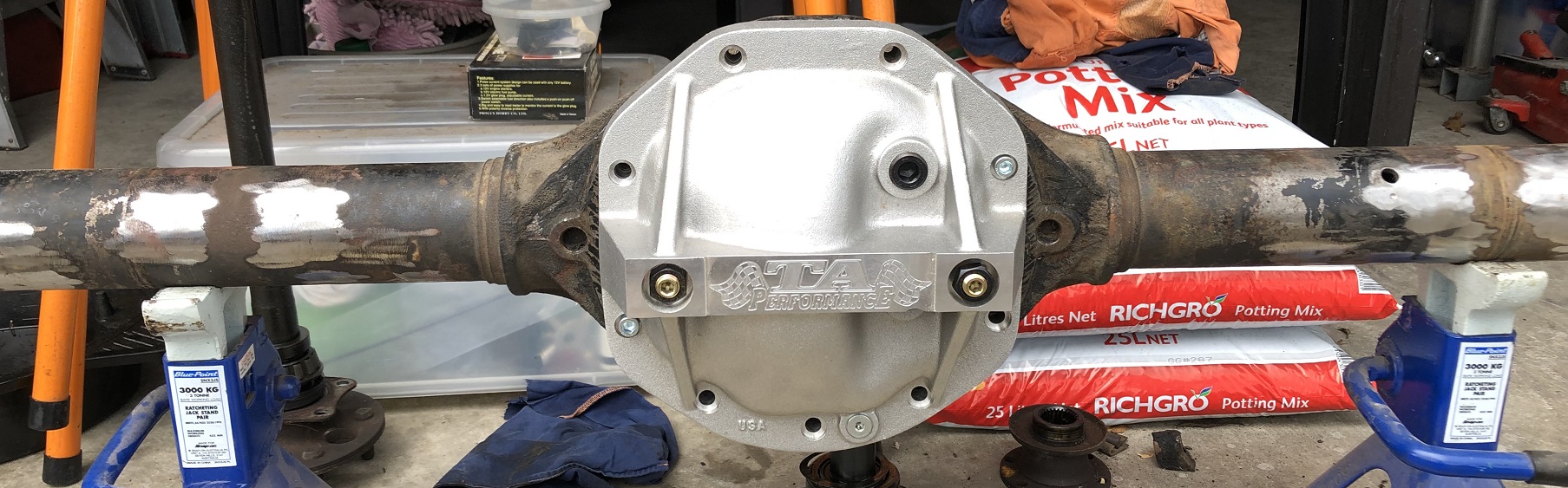

not alot more progress since the last post, however i have given the diff a wash, took a while to scrape 20 years of shit off it and get it half decent, so its almost ready to start putting together for a dummy fit up. (note the pic below is before the wash :P)
in the mean time i just had to see what the backing plate looked like! :punk: certainly looks the part!
i also forgot i purchased arp studs with it! and i need to get the lumps on the carrier bearing caps machined flat so the pre-load screws have a flat surface to press against, so i'll get them off to the machinist soon, i wanted to go and see him to get my steering rack shaft tweaked so two for one!

Is that bung the oil level or the filler plug? Is there is a another bung lower for the level?

That alloy cover looks trick and stiffens the housing to boot
fitting near the top right is for filling, and the one bottom just off to the right of centre is drain, its also a magnetic screw!
