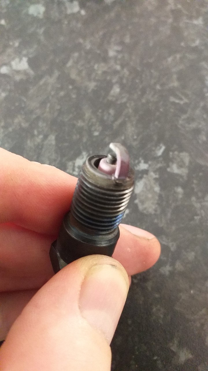

Looks like too much timing on the Calais plugs burning all the way to the earth strap weld

Plugs are hard to photograph with phones. This should show the heat line a bit better.
- Posts: 5638
Yeah that looks better lol

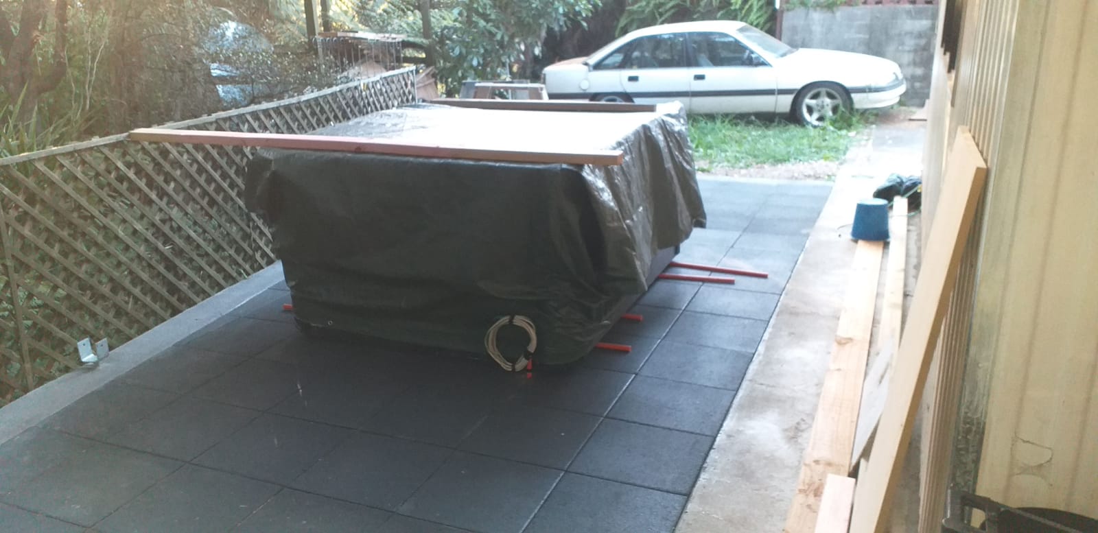

A little progress today, we got the spa pool close to it's final position using a couple of lengths of electrical conduit and a length of 90mm drain pipe to manoeuvre it onto the paving. Next job is to get a couple of my boys gym mates to lift the pool over the wiring coming up through the paving.
