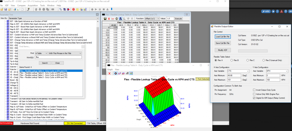

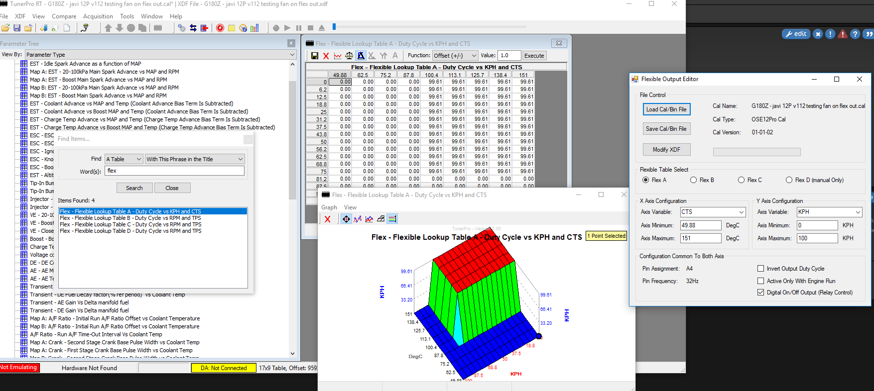

Right, well, i did think 12P had the 2 fan functions in it, but I had never noticed that it does not as I have not used it on my cars. Ive just had a closer look and 12P has notes that low speed fan was removed, and to use flex lookup instead. So, that makes it a little more complicated but it can be done. You need to use the ose flashtool to modify the bin and configure a flex output. Say using CTS and Speed, and select the high and low values that want in a table. Then you choose the output type is digital (relay). Then you use it to modify the bin, and then use it to modify the xdf. Now you have a bin and xdf you can use together. If you want say the fan to be on above 80kph and stop at 100kph (due to enough external airflow), and on at 100degrees, edit the flex a table so that its at 100 in the area you want on, and 0 everywhere else. It wont have the hysteresis, but I dont imaging the signal would be so unstable that it would not work.
Note that I have not used this and I just threw together this example as a test so that I could describe it. You may want to use higher or lower range of values. And I would expect the flex out to switch ground side of a relay. But this should give you an idea what Im getting at. Note that I was using whole numbers, but what you see is rounded off due to 8 bit number precision and is normal and functional.

I was looking at the OSE 12P ECU wiring earlier and noticed the four "flex outputs". That explains how to configure them. Very useful for fans and other applications.
