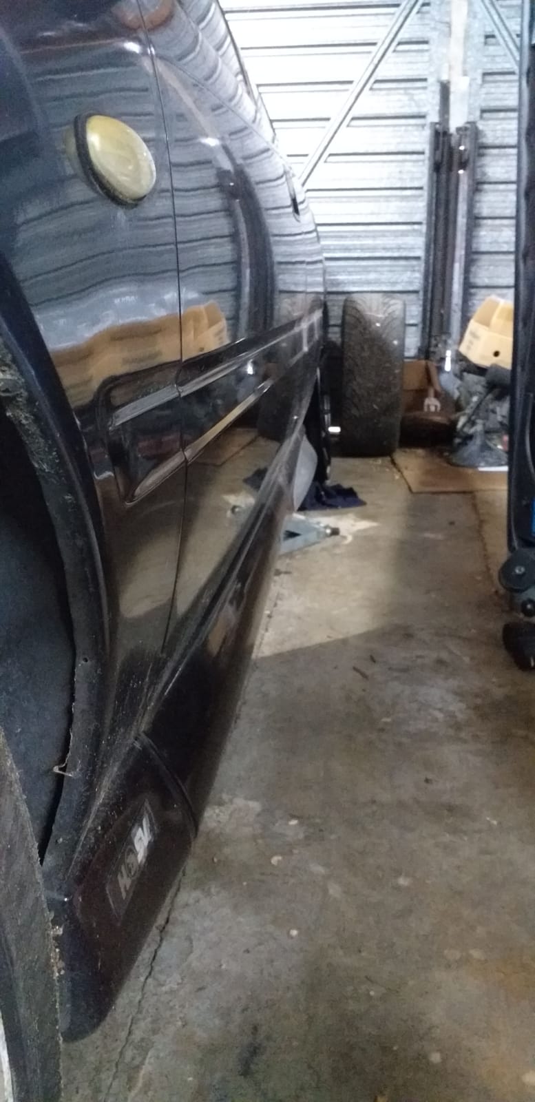

Managed to convince the minister of finance I needed new wheels (I really needed a cheer me up after my first week back on shift, night shift). I'm still on restricted duties, doc says another couple of months. Anyway, I got a set 19x8.5 and 19x9.5 mat black wheels.
Should be able to fit a 275/30/19 on the rear with a more regular 235/35/19 on the fronts but now I need to sort out something for the rear brakes cause the stock rusty ones just aren't going to cut the mustard. Really need to sort out the camber on the rear wheels too.
wheels look good man, and your right the brakes a a bit rough haha!
