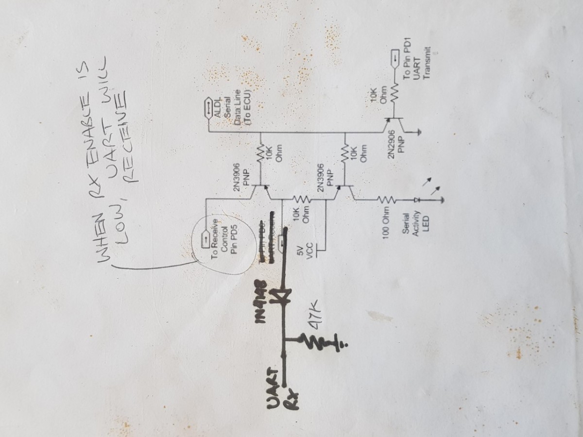

Heres the UART-ALDL interface circuit:
https://electronics.stackexchange.com/q ... low-enough
The receive control pin can be set high when you are sending (inside the ALDL_send function) so that you won't get the echo received back. I'm not worried about that so its permanently joined to ground. But that could be useful for you.
You can remove the one transistor, 100 ohm resistor and LED if you don't want an activity LED
I can't find where I originally found it but here's where I found someone who had the same problem as me (and hence the solution):

Transistors used in the receive portion of ALDL interface circuits can give unpredictable and sometimes frustrating results, as described by pman92 and the link he referred to.
The transmit portion is usually no problem; an open-collector NPN will always drive the bus reliably by switching fully to ground.
I've used the following comparator-based circuit for many ALDL projects and it has proven absolutely reliable. Both comparators in the 8-pin package are referenced to 2.5V, with positive feedback around the initial stage to provide a degree of hysteresis. The second stage simply maintains polarity of the received bus logic state.
There's no hardware gating to suppress echo, as I deal with this if necessary in my software.
