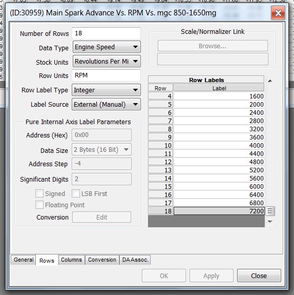

I didn't want to start a new thread. Here is my question can I extend the XDF file so I can increase rpm limit? Please see attached screenshot - Here I added rows 17 and 18 and gave them the same 400rpm increment. Or is this the wrong way to tackle this?
Thanks
Extended RPM Table.jpg (106.19 KiB) Viewed 12312 times
Posts: 5623
Re: The1's Enhanced Factory Bins
No you can't just change the xdf to add rows or colomns
L67PSI
Posts: 178
Joined: Mon Dec 12, 2016 11:27 am
cars: L67 VT Calais
Post by L67PSI »
Thanks for quick reply. So what are my options here?
Posts: 3676
In short, there is no simple answer unless you want to re-write the whole code.
