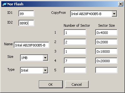

The following is my pinout description.
I have also PM'd you a Zip file called BDM Instructions and Pictures.zip that was created by 160plus (I believe) that I lightened by 87,681,705 bytes (103.9m->16.2m) simply by striping the Metadata from the images ... Hopefully, that does not offend him.
Pcm 90 pin header -> BDM
A-4 = GND -> Pin 3
A-7 = DS -> Pin 1
A-11 = DSI -> Pin 8
A-13 = DSO -> Pin 10
B-12 = BERR -> Pin 2
C-12 = RST -> Pin 7
C-29 = DSCLK -> Pin 4
C-30 = Freeze -> Pin 6
F1-20 = +12v
[edit] The following is one time configuration ...
When you open the BDM Software you will want to (if not already done),
Select: Tools
Select: Config
Select Category: Other
Select Protocol: BDM
Select Target Select: ECU4111M
Select: Ok
[edit] See Screenshots below ...
Select: Tools
Select: New Flash
Select: Nor Flash
This is where it gets tricky to write, What chip, Intel or AMD ... I'll example AMD ...
Select CopyFrom: AMD AM29LV800BB
Edit ID1: 01
Edit ID2: 2258
Edit Name: AMD AM29F800BB
Select: OK
For Intel (NOT AMD), I soldered a resistor to WPP(VPP) -> switch -> +12v at F1-20
Hopefully that answers all your Q's.
[edit]
Screenshots of the USB BDM NT Nor Flash dialog for the AMD and Intel 1m chips
AMD AM29F800BB Nor Flash dialog
Intel AB28F800B5-B Nor Flash dialog
