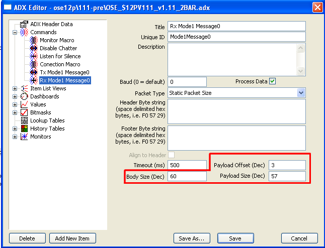

Ok, just the adx i already had loaded, but what about editing the mode1 rx here:

should we get VX L67 Getrag to give us a Received line? Might be slightly different than N/A you think? Same as we were just talking about in the other thread lol

Hmm I'm intrigued, what does all this mean & do I need to test anything on the vs L67 I have here?

he's saying instead of editing each item and changing the offset just do it once there and it should do the lot in one go.
