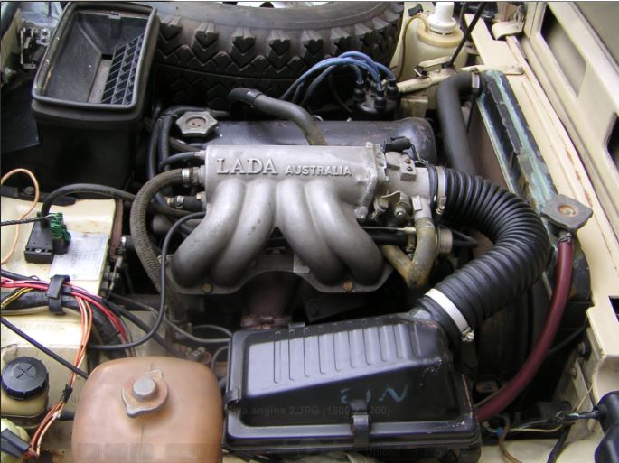

So you went to all that trouble to put EFI on, and yet you have LPG too.
You never drive on petrol?

Not really, that was just an image of another Toro engine bay I had.Circlotron wrote:So you went to all that trouble to put EFI on, and yet you have LPG too.
This was mine
