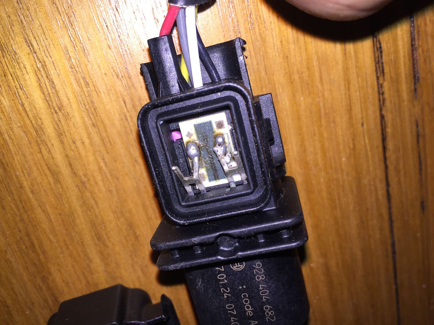

antus wrote:Methanol: very roughly +5 degrees?
Also with the wideband cable, not sure on that type of connector but i believe the bosch units have a calibration resistor in the connector. If you change the wire or plug you may effect the readings. Decide if thats worth the risk and maybe take some baseline readings from a car in a known state (idle at x degrees temp) and repeat after modification to test for changes that may have been caused by the cable mods?
Cheers Ant, and this is what it looks like
I assume it's on the underside of that little board
