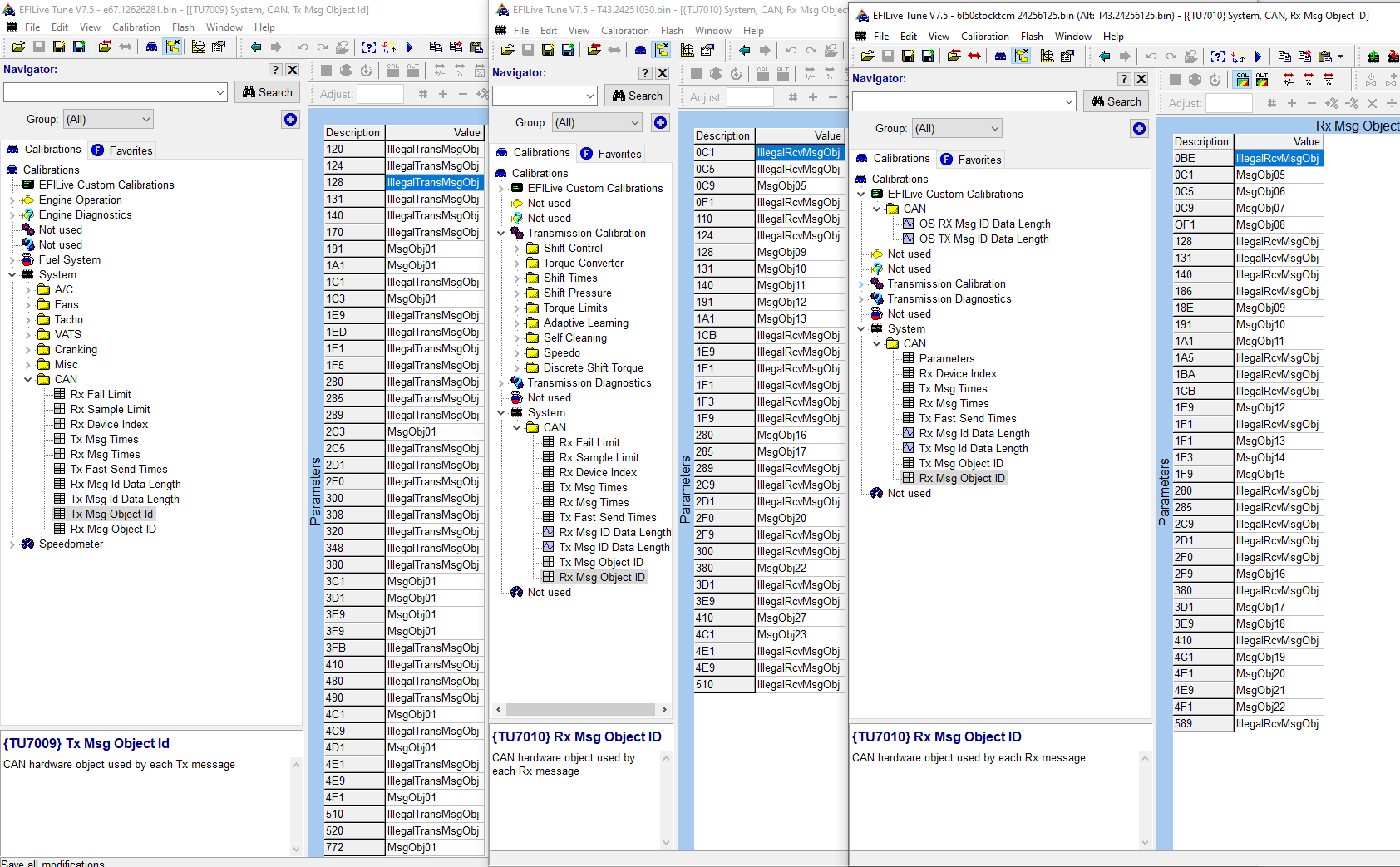

So im using calibrations:
Engine 12626281
Trans 24251030
I attached the bins. i dont have an XDF for the engine bin so im not sure if it has exported properly

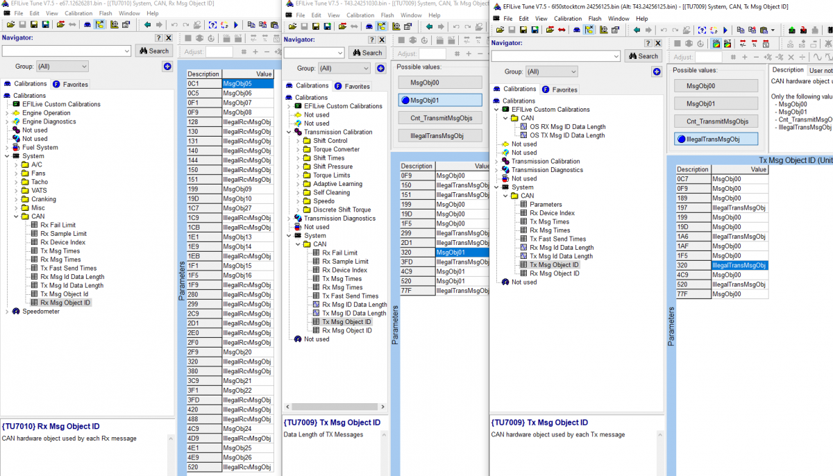

Re: T43 TCM Finding gear ratios in .bin
Post by Tre-Cool »
well ecu was easy to work out, it has the same can id's as e38 os 12612381 & the memory locations for all the can stuff are in the exact same spot too.
it should be possible to just make the 24256125 calibration work with the ecu. I'm curious to know if you tried this & what error you got. There is nothing that really stands out between the 2 different tcm can TX id's. there is some slight differences in RX, but as you can see in the screen shots the ECU is not sending data out on them. I highlighted the 320 can id because I KNOW that this is required to be turned on to make an 09 tcm talk to an early 06-08 ecu.
The older tcm os also has a few more devices index's configured to the ecm then the newer os too.

Wow awesome. I never actually tried the 6l50 TCM because everything I could find out about it said it wouldn't work so I actually bought a 6l80 TCM and flashed the corvette os onto it to test before I bought a 6l50
Even with the corvette os I had to disable the u0100 u0101 codes in the ecu and TCM to get it to work at all which annoyed me
I would love to know more about the screenshots. I see some have things like illegalMsgRcvObj any chance of a little bit of an explanation? Or point me to some info somewhere?
