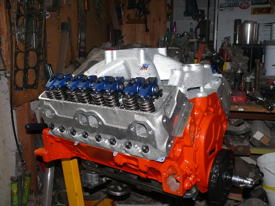

Not at this stage, Ive been busy building a couple of engines(HQ 350 Chev,HR 186 Holden & a 308 HJ 2door) fitting them & tuning for other people, so that's burnt any spare time that I had. Should be able to play with other things now, I'll just have to learn to say NO.

A little update to the chev engine above, it ran 11.7 @ 115mph using max revs of 5200 & not much traction in a HQ ute, so it has got plenty up it's sleeve when he opens it up.
