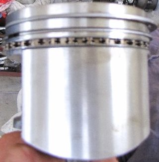

the duralites are not the race series ones, but they are still plenty fine, they are whats in my motor
the main difference I can see in them is they have a bigger skirt than the race series pistons.

last time I looked race series pistons had thin top compression rings normal duralite is 2mm race series is 1.5mm and short skirt

that was a while back tho might not hurt to check
Re: DELCOS NEW RIDE
it doesn't really matter
if they are duralites it will have it cast into the underside of the piston on one of the skirts from memory.... either way they will be perfect for what you want!
Re: DELCOS NEW RIDE
so heres the best pics I could find
firs this one is the duralite, full skirt.
race series piston with less skirt
so if your saying that there is reliefs for the crank then its probably the race series ones you have.

yeah looks like the 2nd pic but more dished should be bulletproof compared to flat top 40 overs or stock 3.3 black flat tops with 20 cent peice size dish in the middle LOL

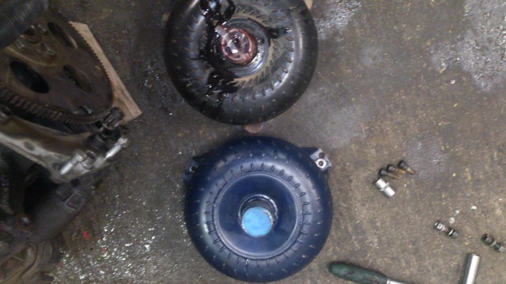

upgrade time for the vb swapping 3000rpm boss hog convertor for 3000rpm B&M nitrous holeshot totally different blade angles as can be seen in this pic say its going to be much tighter

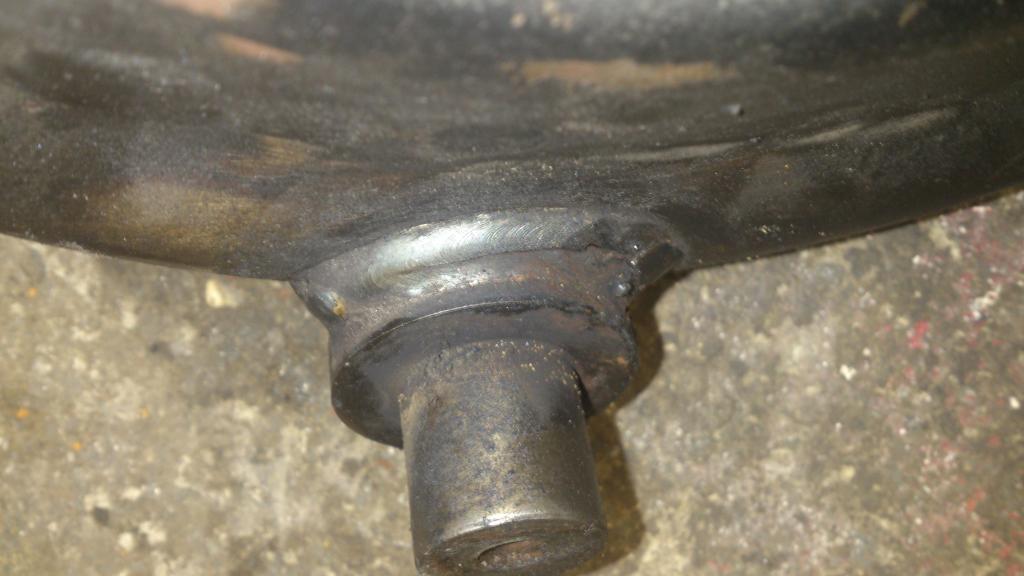

cracked lug weld on the old convertor

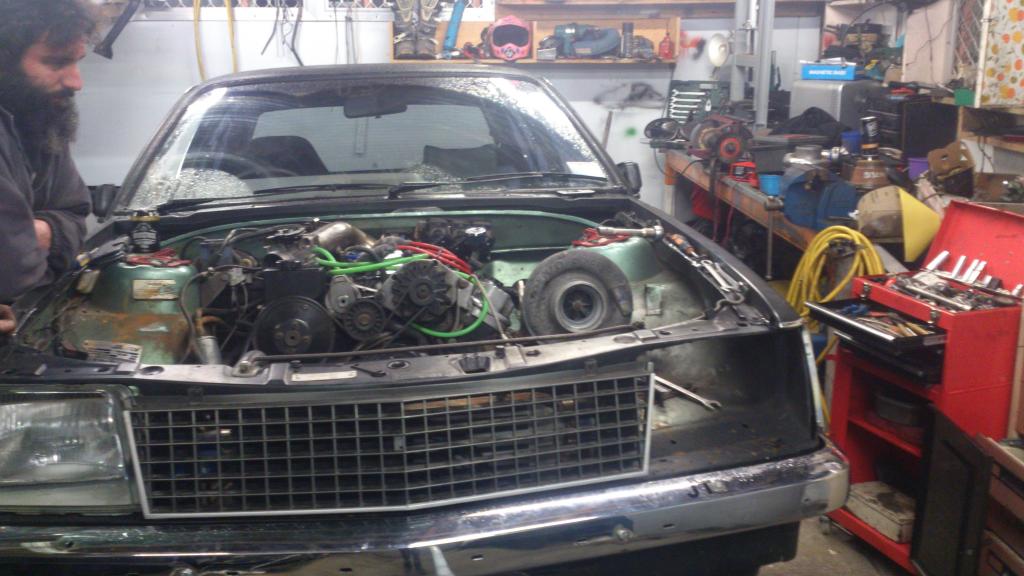

set of front mount manis we have lying round not getting used
and the main new upgrade HX52 65mm inducer holset

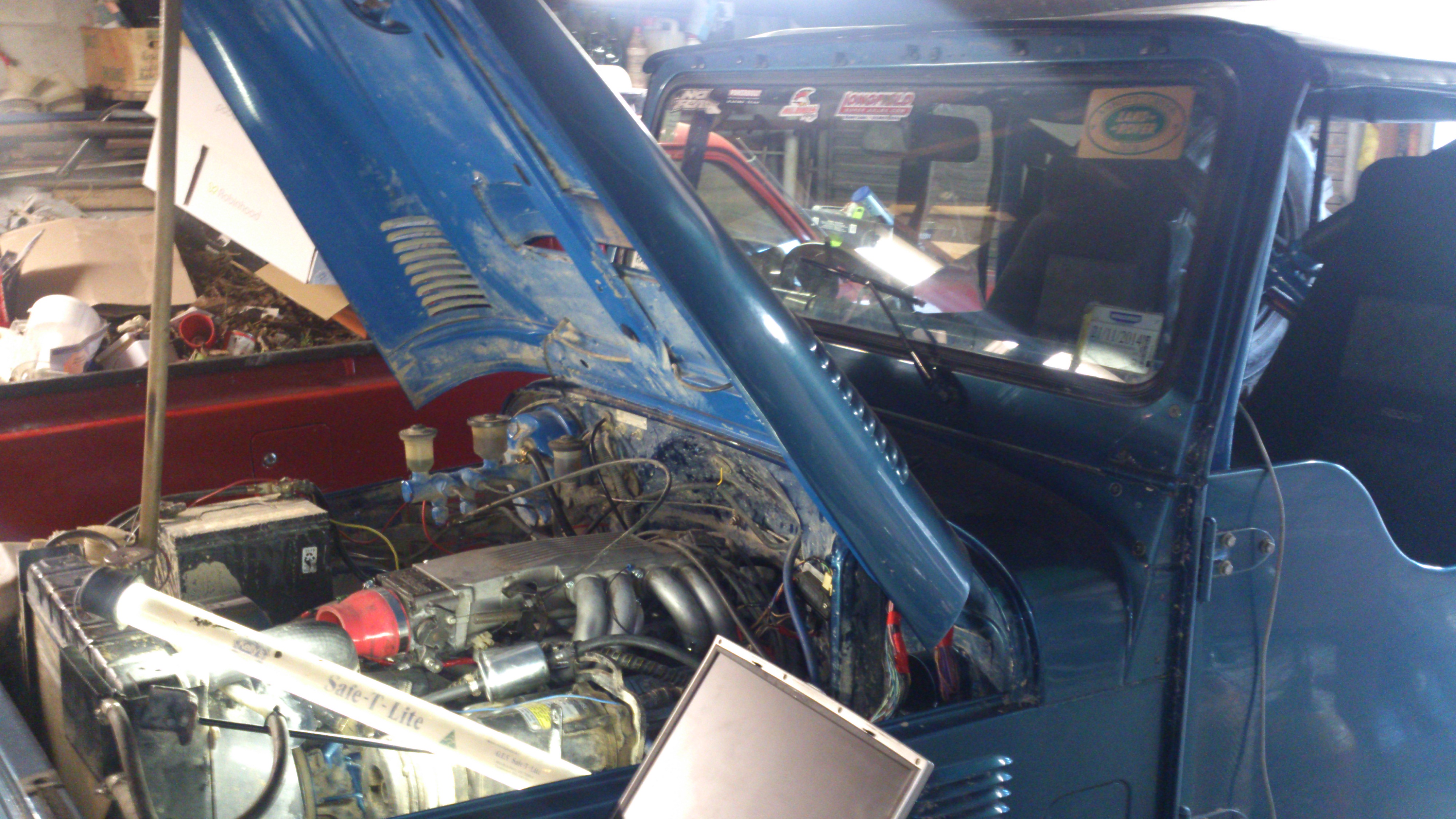

last couple of weeks effort carb to TPI and 808 conversion in a SWB landcruiser .fired it up today few issues 1 injector keeps sticking open coolant sensor was dead alt not charging.fix them up during the week and onto tuning

is that an old Toshiba tecra laptop?
