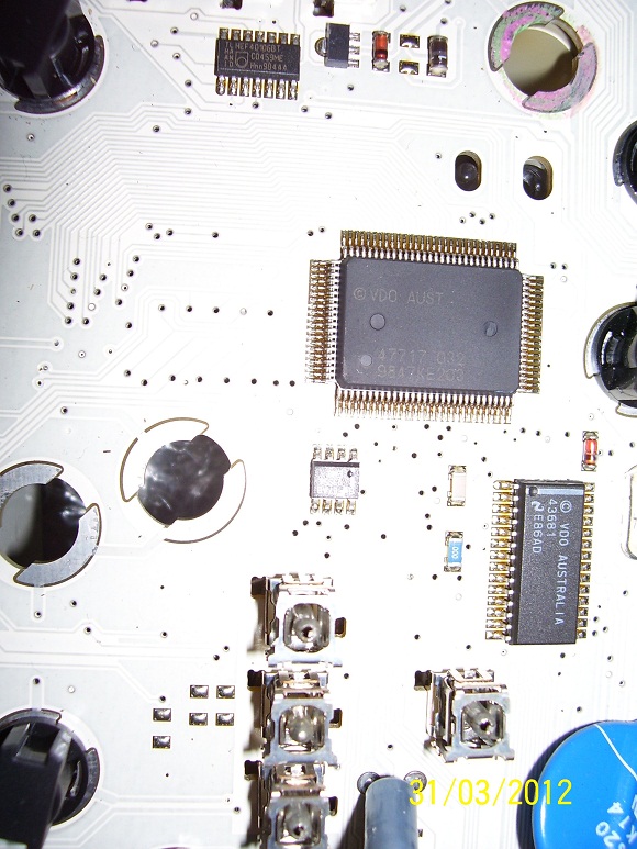

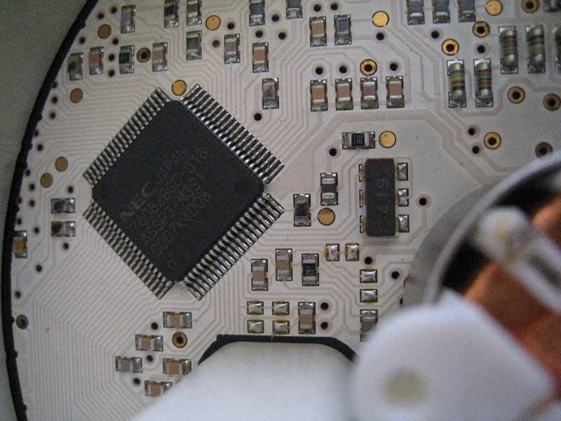

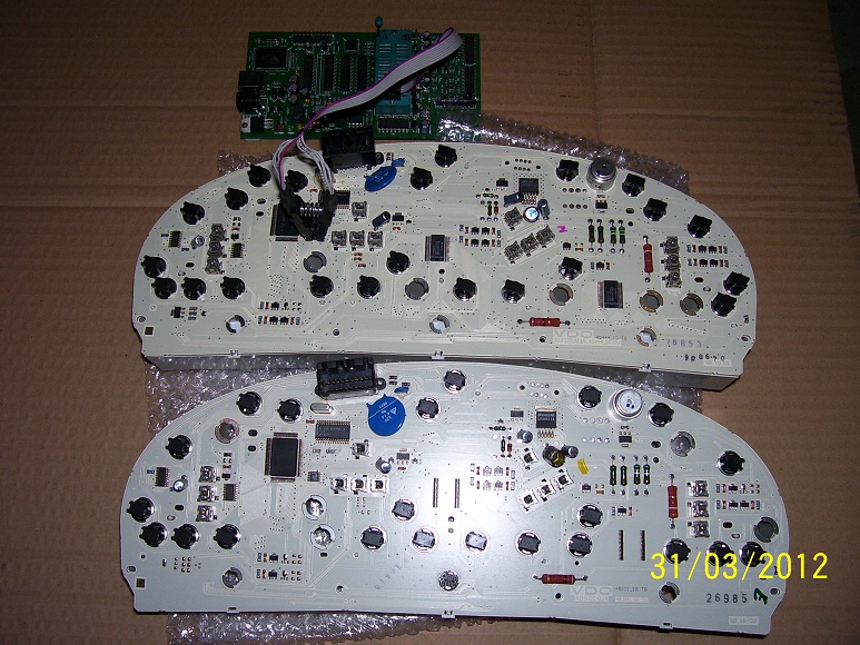

- Posts: 2959
Re: VT-VX Clusters
These are the 2 types.....
But to do VX's you need different software & programmer (NEC mcu type) VT you can just do by removing eeprom & read then write... unless there's someone out there that could do it over the BUS...
- VX NEC MCU type chevroletp.jpg (86 KiB) Viewed 4775 times
- 2 vt clusters with eeprom.jpg (250.28 KiB) Viewed 4775 times
- Close up of eeprom.jpg (225.39 KiB) Viewed 4775 times

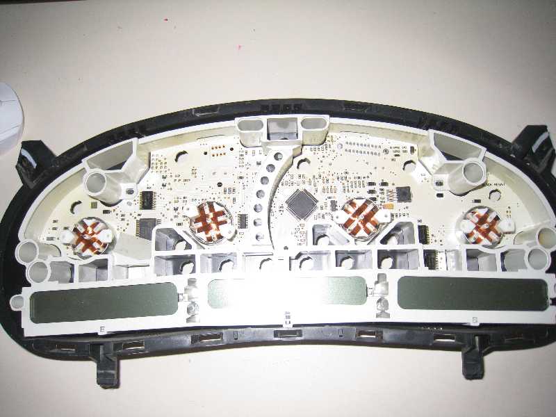

Re: VT-VX Clusters
Hi Guys,
Tiping i have the later model cluster as it has an NEC EEPROM.
Am i correct??
which is the best programer?
What is the best technique to lift pins?
thanks
Daniel
Am i correct??
thanks
Daniel

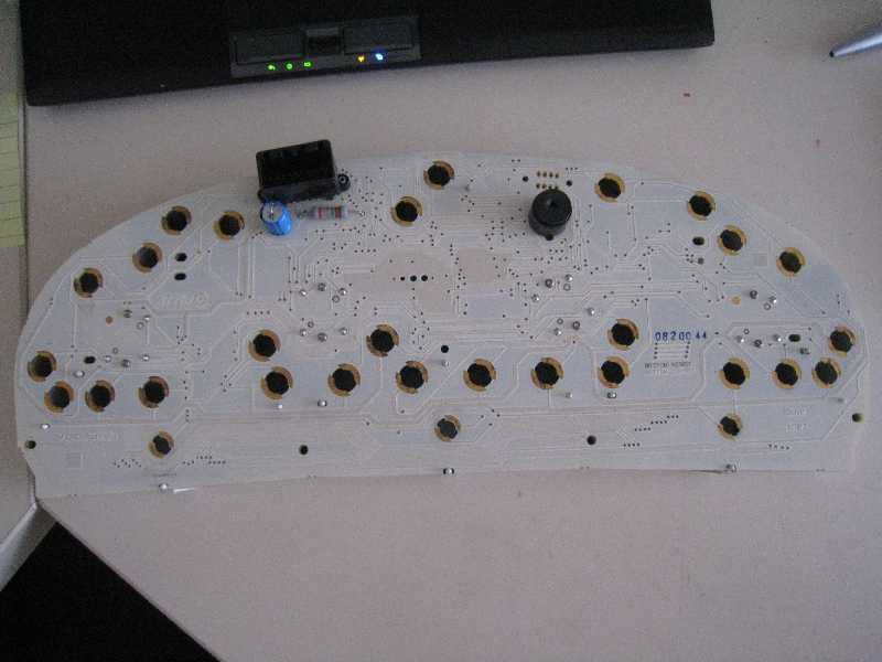

Re: VT-VX Clusters
You're looking at the front of the board check the back side to see what eprom it has.
Re: VT-VX Clusters
Thank you.
Bottom has nothing except plug, cap, res & speaker....
Thoughts?
Thoughts?
