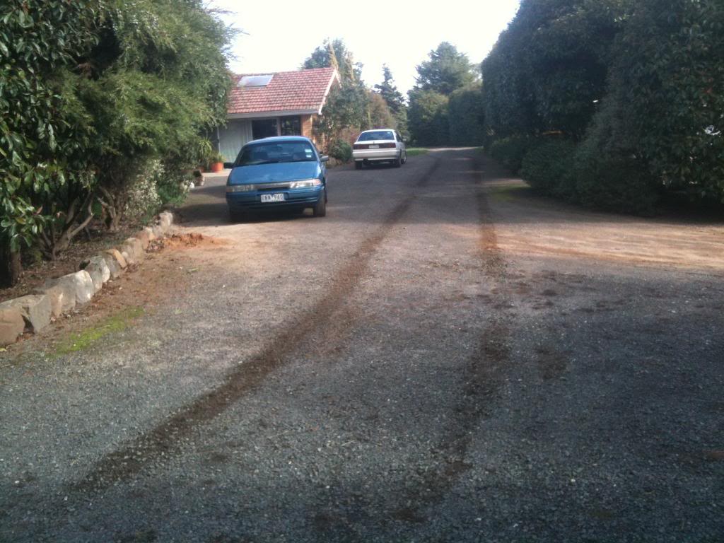

I got my red VN s1 with T5, can you see it?

Na but I can see where you changed gears :thumbup:

Yeah the S1 manuals are pretty good down low, its all over by 4000rpm though!
edit: is it on the right in the trees?
Re: Vlad's VP executive (full restro)
No, vs ss got it in one. You can see where its been though

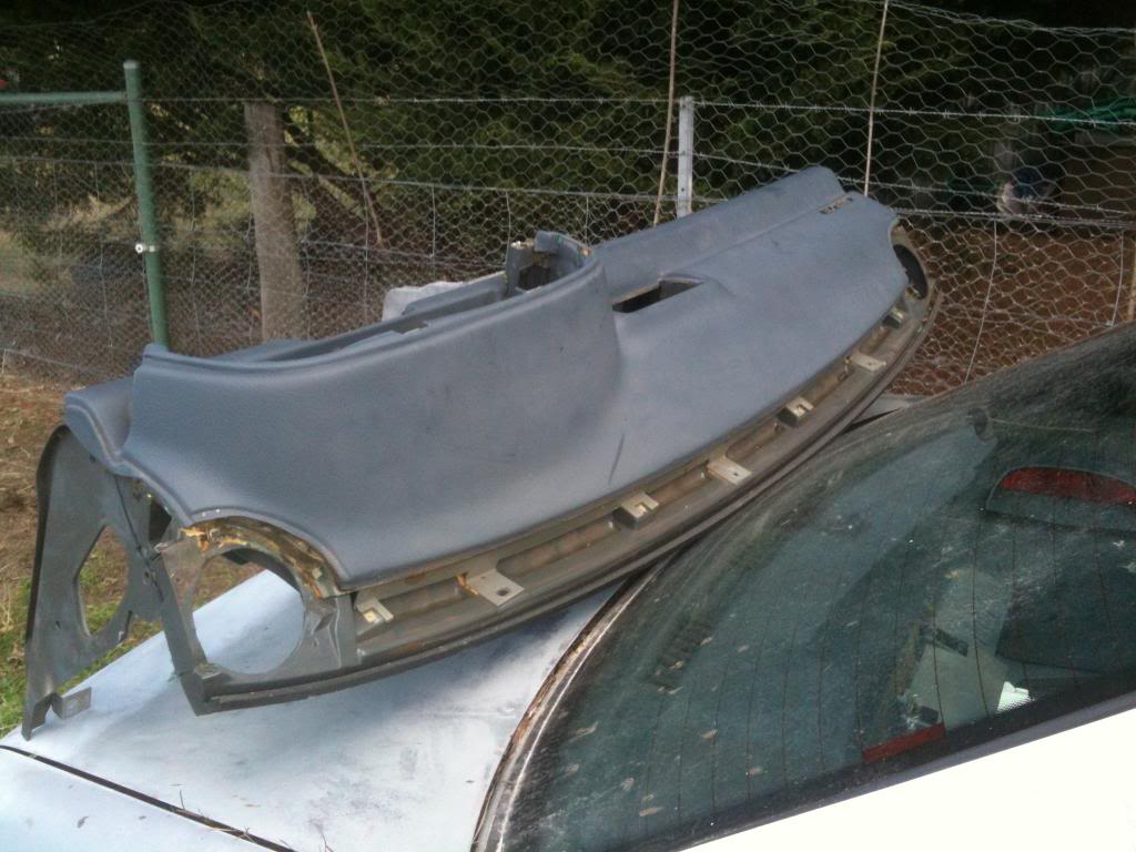

Pulled the dash out of the parts berlina, the dash isn't too bad and is already the correct color that I want, so I am stashing it for now

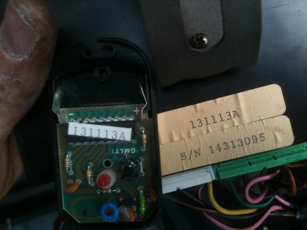

And as I suspected the VP remotes match to the anti theft module.

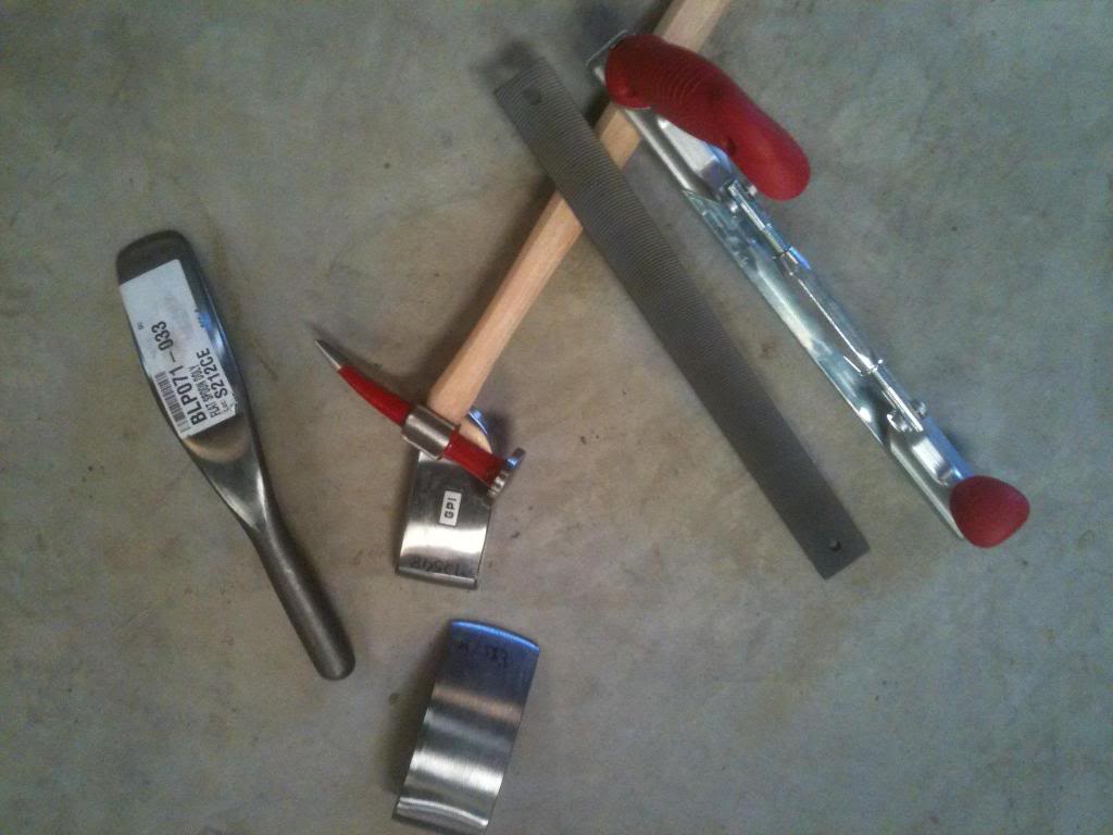

tools :thumbup:

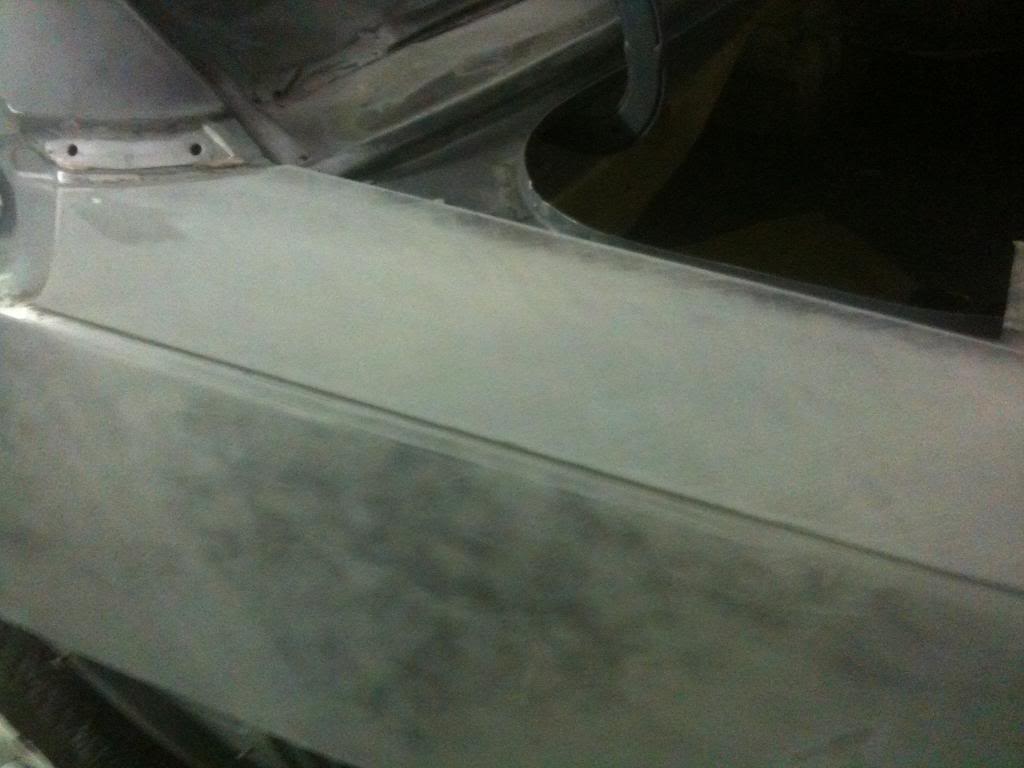

Had a go at blocking the existing factory primer. its super easy to sand and sould save me a lot of work and not requiring as much new primer.

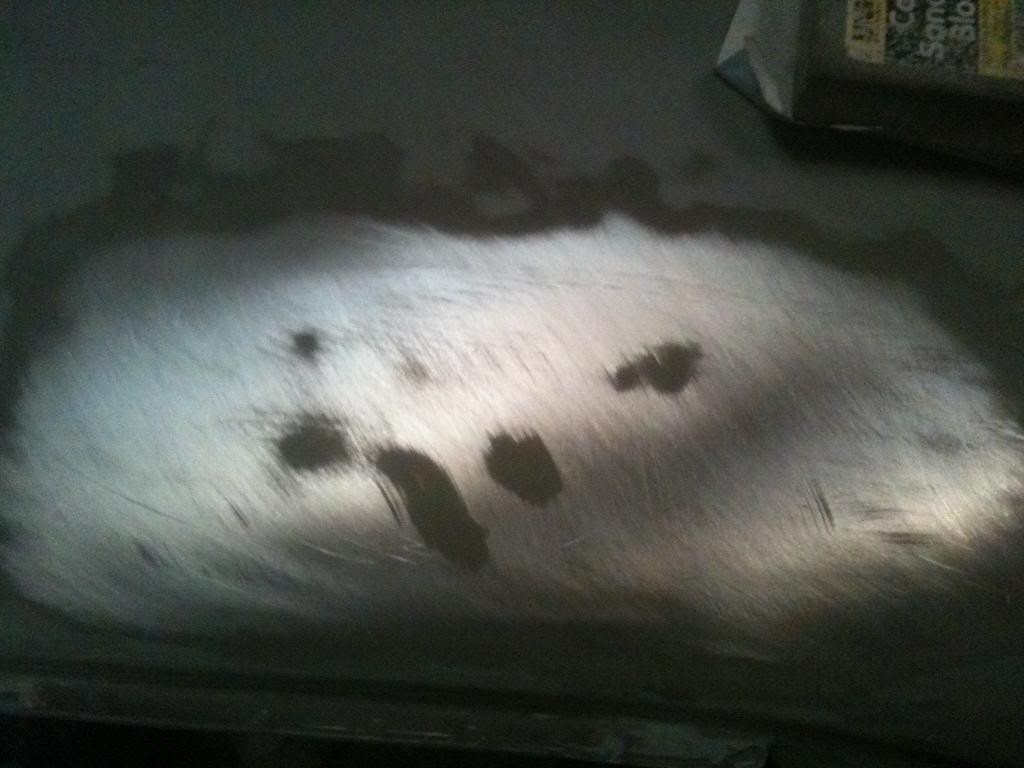

After some few hours playing around with the dollys and hammer I got this part pretty good, filed it with the panel file I bought to check flatness and seem pretty damn close, did a bit more work after this pic was taken.
some primer to see the result, looked pretty straight.
