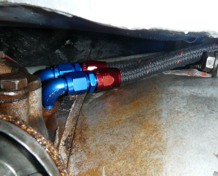

well i've finished the oil cooler lines .... i almost think it would have been easier to remove the tranny to get the fittings put into the side of it!!!!
speedflow sells this stuff which is "nomex/kevlar braided hose" its basically a rubber hose that has like a material type braid over it, rated to 200psi and all sorts of fuel and lubricants .... slightly cheaper than the steel braided stuff and alot easier to work with, so i went for it, thinking i might replace some of my fuel lines down the track with this stuff, the speedflow fittings are re-usable and very easy to work with aswell as disconnect if needed!
also got some fittings to allow me to keep my tranny oil temperature gauge!!

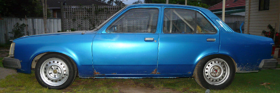

so i had some spare chaser rims sitting in the shed and as the current front rims on the gem were all rusty and the tyres are too big and scrub on the guards, so i decided to get the spare rims cleaned up and put some cheap smaller tyres on them.
So i took them to my mates workshop and sand blasted the front of them and them painted them and i also went from 205/65/15 tyres to 185/55/15 tyres ..... i went to me mate and said i want 175 or 185/55/15 and they need to be speed rated to atleast 200kms :driving:
2 x 185/50/15 nankangs 240km speed rating for $100 each i was happy with that! and got plenty of guard clearance!
so got them all fitted up today and on the car, only problem is they are more "silver" than the rears so i think i'll have to pull the rears off and give them a spray to :P

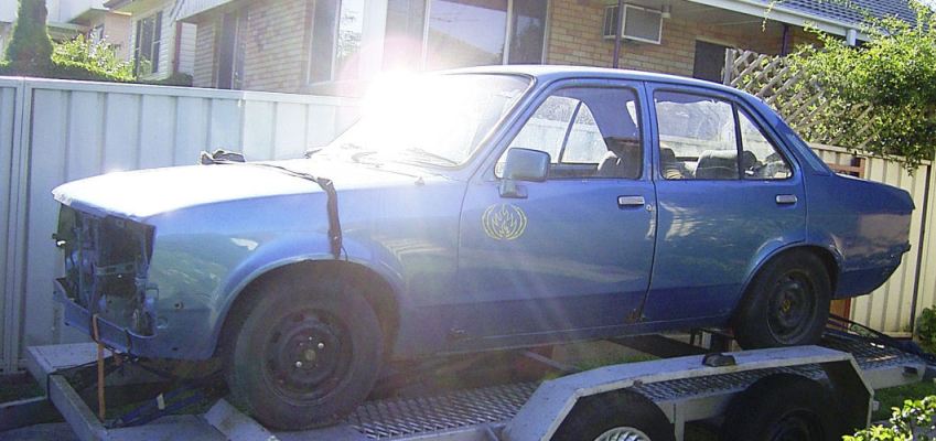

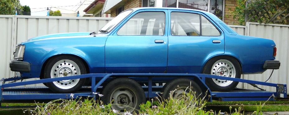

i had a flash back when i was loading the car on the trailer and thought WOW that looks different to when i first got it, so just for shits and giggles i thought i'd post a pic of the car the day i got it and a photo today (just over 2 yrs later) and im proud to say i think i've improved the toughness look of the car :punk:
the day i got it home.
today
pleasee note i haven't lowered the car at all, the commodore wheels just fill the guards better plus there was no engine in it when i got it and now theres a 6 in the front!
