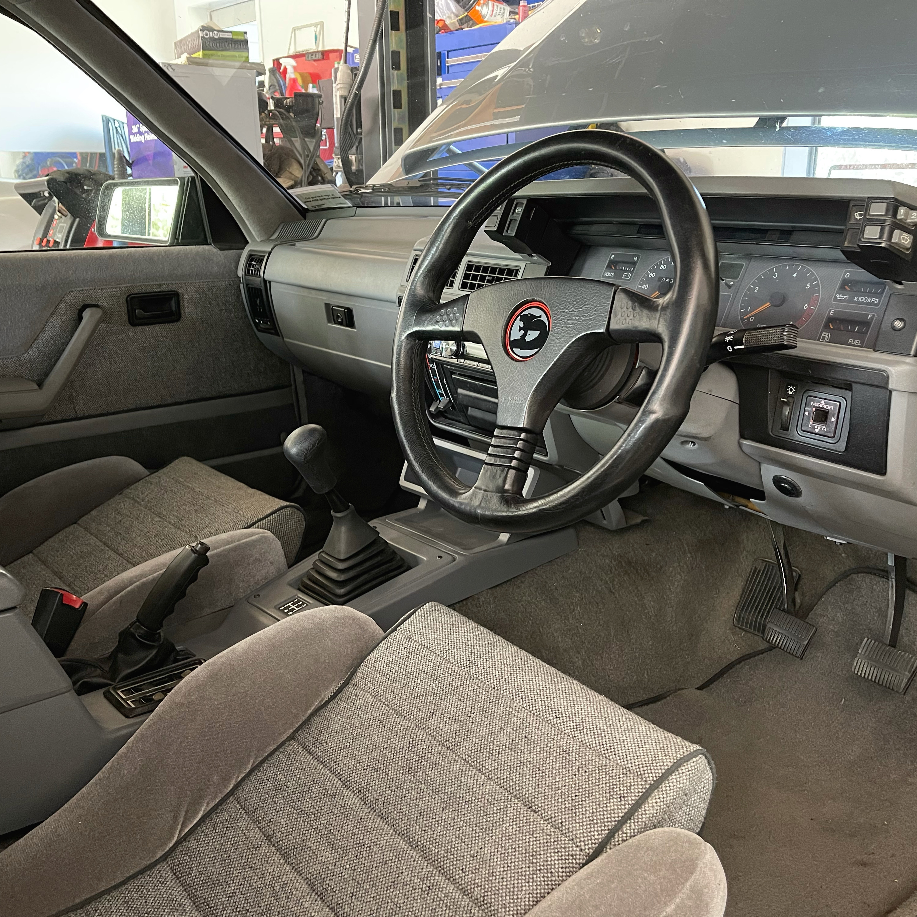

Looks like a nice ride
It’s only a idle issue. This car puts a smile on my face each time I drive it. It’s taken 8 years to get to this point collecting parts. Majority all sourced from Australia.
I had to squeeze the throttle a little to see what could possibly be in there. Excuse my slight retardedness. I’ve also since recently received my Walky wheel back from Gary West Upholstery and fitted it. https://vimeo.com/491878355
