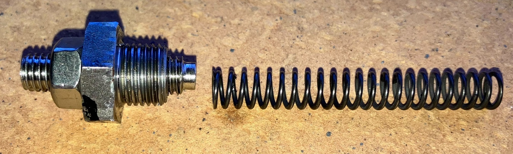

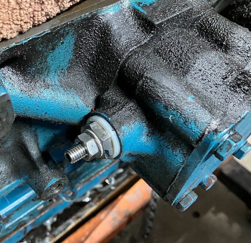

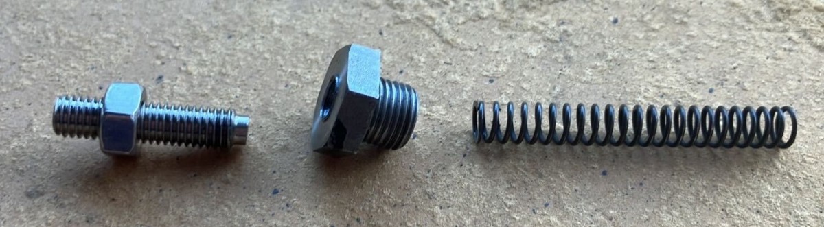

Got the rest of the parts i needed to complete this adjustable oil pressure do-dad.
This setting is af far out as the adjustment goes, and would put it on the original bolts collar, so theres plenty of room for adjustment, i've heard 2-3mm shims is what people put in them, so i have way more adjustment than that (not that i expect to need it)
