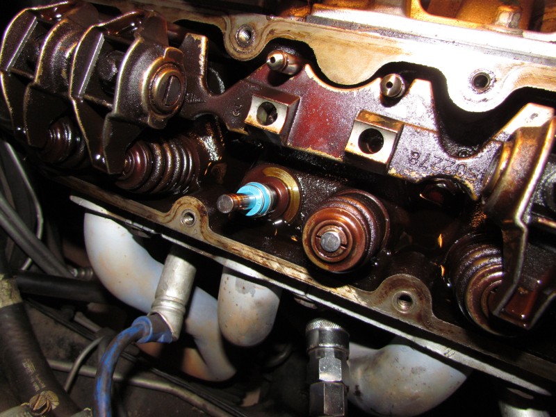

mace recommends John Hamilton for engine work as mace does not do engine work at all, just upgrade stuff. He is the guy who only does ecotecs and does the oil mods, pic curtsey of him. No one else does this, asked some of the big builder about this before and all don't believe they have oil issues and wont do the work required to correct it.
When I am ready my engine is going to John, he knows his stuff on these engines. I could probably do it myself but with some one like him, no doubt it would be done shit loads better than I could. After all I am not an engine builder :lol:
Re: The1's Daily
you'd probably find as well there's a lot of motors out there like the one I got that was filled with sludge build up from lack of oil changes, this would only exacerbate the oil feed issues!
I actually had to gouge out the crap to find the head bolts!

Here's mine when i was installing the rockers.

Holden202T wrote:you'd probably find as well there's a lot of motors out there like the one I got that was filled with sludge build up from lack of oil changes, this would only exacerbate the oil feed issues!
the failed engine I posted few up ^ had sludgicles hanging from the intake manifold to the valley lol. the sludge is what caused it to fail as it block the pickup.
Re: The1's Daily
the one in my pictures went surprisingly well for what it looked like inside hehehe but I didn't really ever do much with it other than daily driver.
