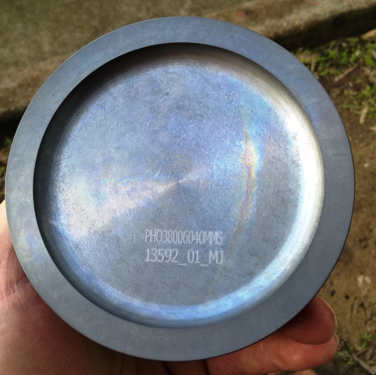

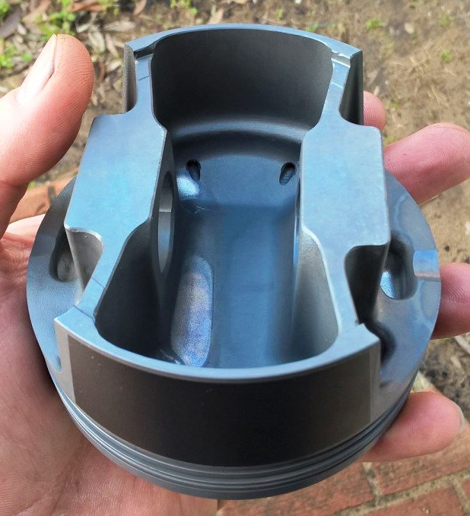

so been a long time with this one, he changed the diff and got a B&M shifter for it, and went back to Gunnedah, in the end he only got two runs in and muffed gear changes and such.... long story short, he hit the rev limiter a few times on boost and it also over boosted before Gunnedah, and also was just going lean at the end of the revs (fuel system limiting I believe), so I think a combination of things might have caused the issues, its pretty much broken the ring lands of all 6 pistons to some extent, some were just tight in the piston, others had slight cracks in them but the end result was fairly conclusive :)
the original decision to go for the hypatec pistons was just that it was a massive price difference and he decided to risk it rather than spend the cash on it the first time.

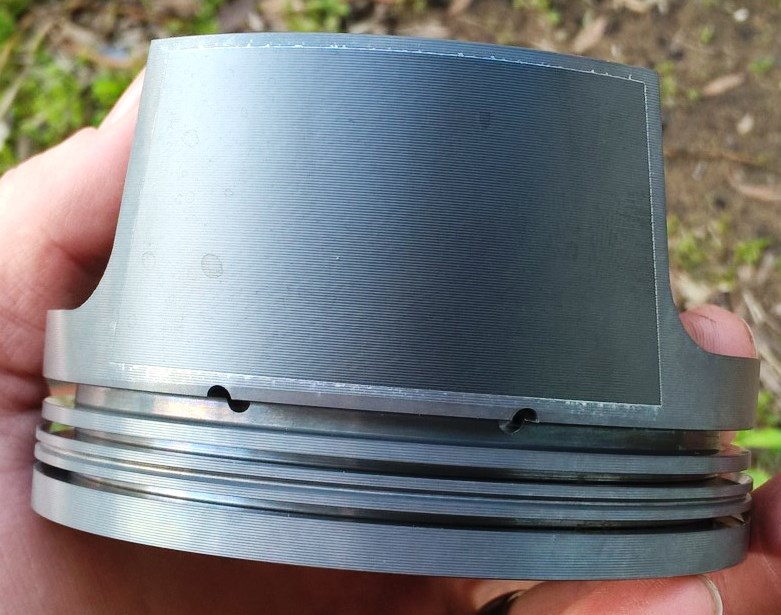

so we've gone with the option of mahle forged pistons from precision, and I must say they are a nice looking piston compared to the cast ones!
one thing I found with the hypatecs is that all the failures were where the split is in the skirt, and the material between the rings is actually narrower than an original piston, so I wanted to make sure the new ones didn't have the split kirt, so rang precision to confirm before we went with them!

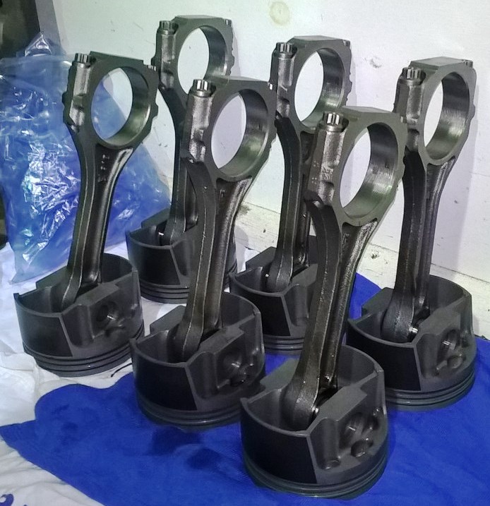

so I've got the pistons and rods all ready to go, I've cc'ed the dish and measured the difference in compression heights, just waiting on the other bits to get prepped then I can start assembling it.
Re: Mint VP V6 Sedan soon to be boosted!
oh wow! they are nice. They are the alternatives to the ones I bought, but look hell of a lot stronger.
Im NA so I wanted cast. I'll keep those in mind on the next engine one day.
