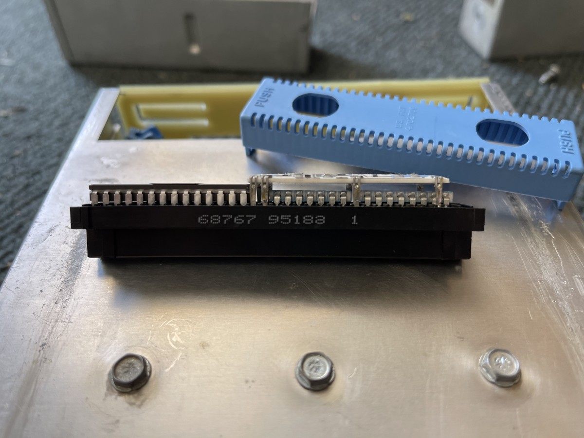

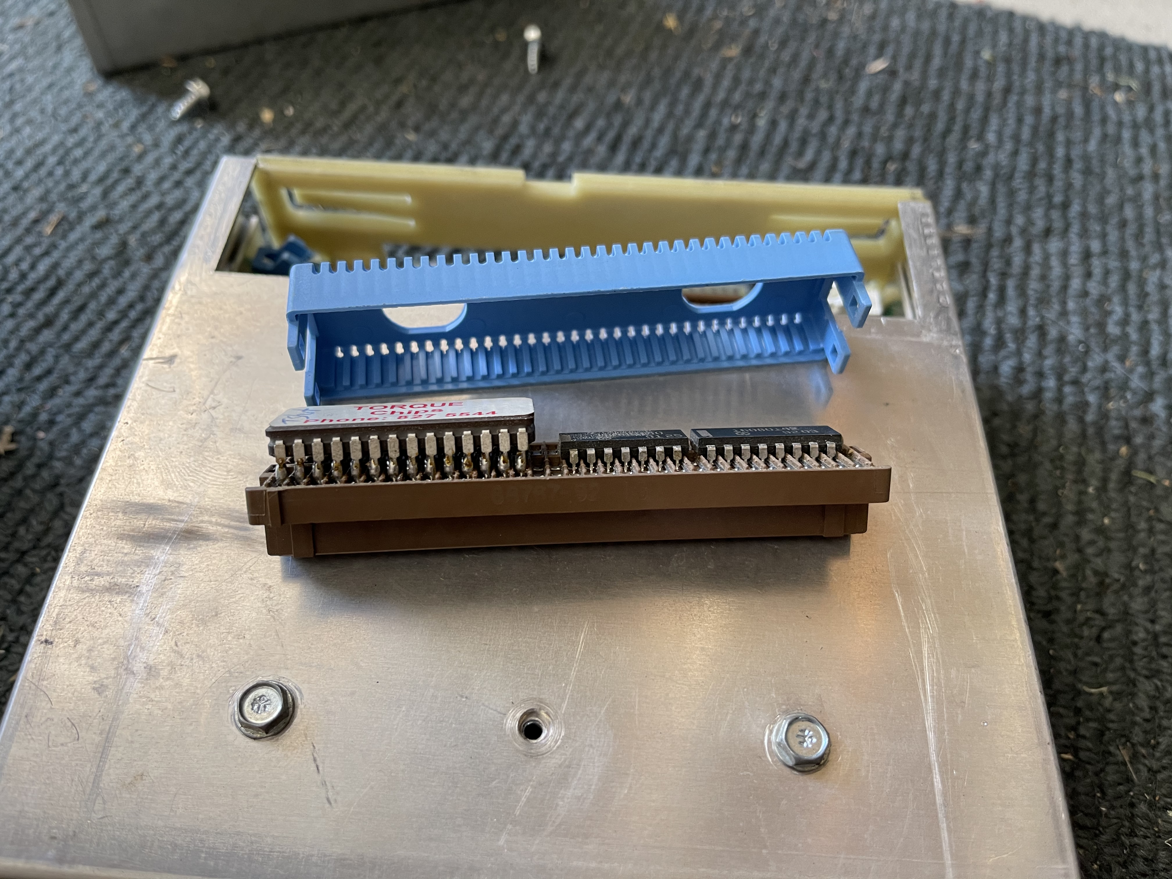

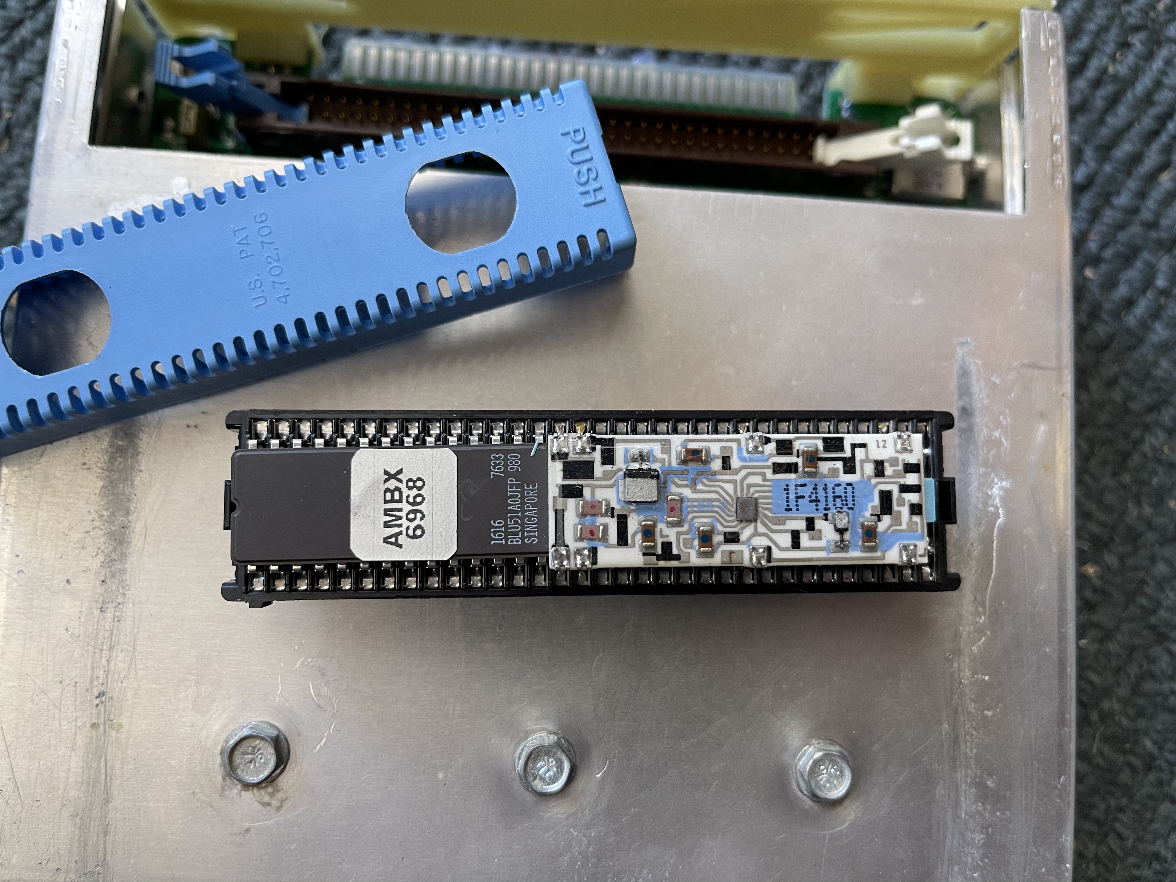

Thought I’d take the cover of the Walkinshaw memcal (last 2 photos) and see if anyone could tell me any more about it?
First photo is of another memcal I have that is supposed to be a 215kw tune for a banana manifold. For comparison.
'quipt4it
Posts: 675
Re: VL Walkinshaw Build Electronic Issues
Post by 'quipt4it »
Maybe try the memcal ID tool
Kojab (member) is a bit of a gun when it comes to I.D'ing these things.
PM or just wait till he chimes in?
ID tool says its based on the $5D code like the early VN, There is mention of a service fix for idle and surging late in the $5D production run for both V6 and V8, around 1991.
You could try BAYA 7003 VN group A tune which is based on the later $DB code and says it has a service fix for idle.
