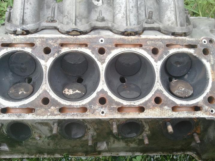

The exhaust valves are liquid sodium filled and have a habit of losing their heads on contact and making a real mess of the combustion chamber and pistons, but they look to be in one piece still so as long as there's no piston damage then it'll just need a new set of valves and cams.
Not really sure why it happened - I was driving it a couple days ago and nothing has changed except the alternator...
Kind of regretting changing the cams over now :(

4 bent valves, but the head is r/s due to a lunched cam journal :rant:
Pistons and liners look ok though...

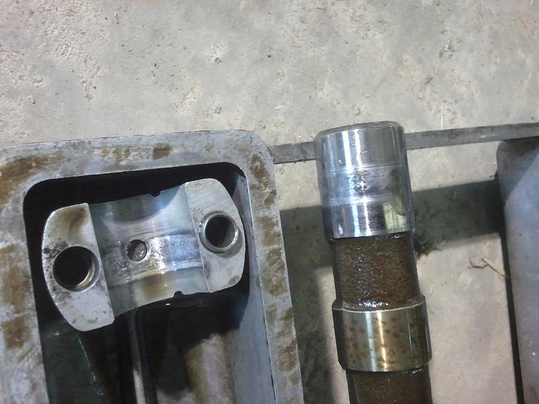

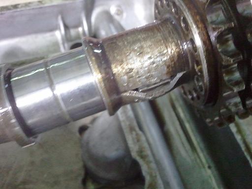

Camshaft:
Cam sprocket has shifted - tabs bent and the lock bolt is probably in the sump
Rear exhaust cam journal chewed out:

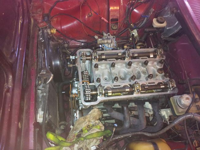

Head off, cams out - spot the bent valves...

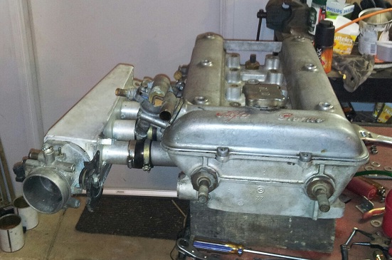

7 months later, I've finally made a bit of progress :oops:
New head decked, new guides, seats cut, slightly hotter cams ready to go:
Almost there...

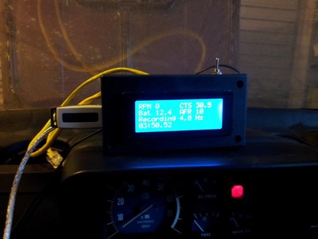

I gave my datalogger a bit of a test, I'm pretty pleased with how it's going but I still need to sort out the decimal point for the bignum font - it currently displays as a zero.
and I finally got around to mounting my tacho
