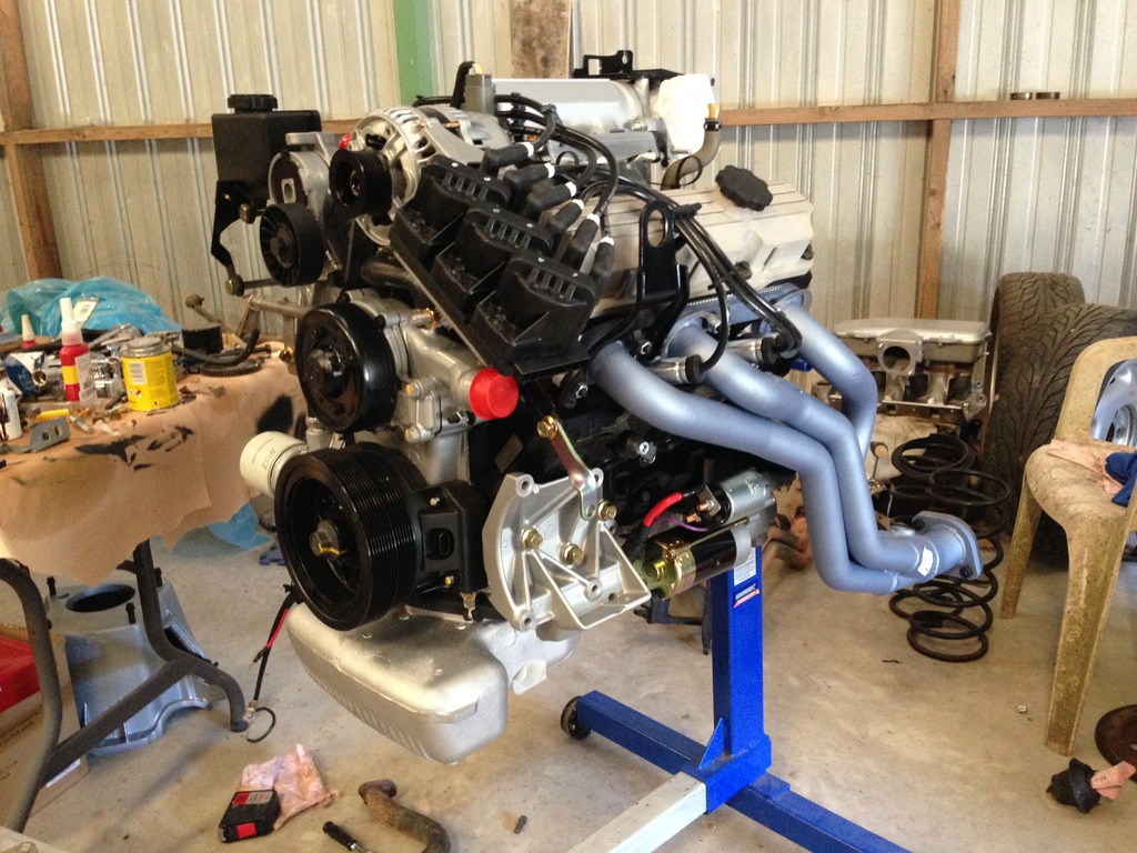

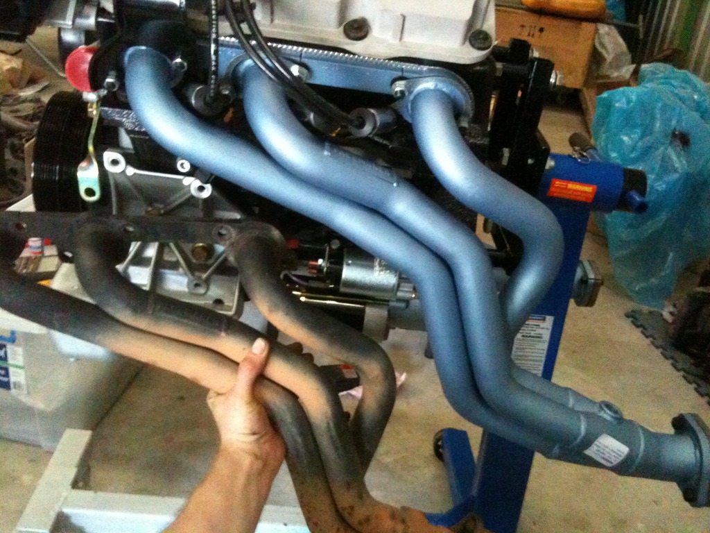

extractorses!
Bit of a difference.
Nothing make an engine look as good as clean headers.

While they are nice and new, I would get them hpc coated. Such attention to detail has gone into this engine, that paint they come with doesn't last long, and they will look second hand quick smart. Great job is what I'm saying and that coating won't be up to your standard in 1000ks.

You are talking to vlad lol
I already said I'd get them coated. Satin black ceramic inside and out.
Jet hot in Castlemaine do that same blue in ceramic too. Either way both look good. Better than chrome ceramic finish.

vlad01 wrote:I already said I'd get them coated. Satin black ceramic inside and out.
Sorry mate. A lot goes on in this thread. I must have missed it. Looking great. :)
