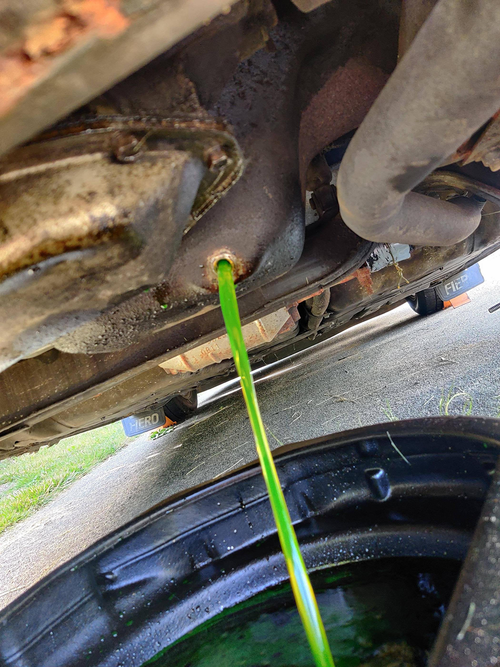

Standard Oil Change.

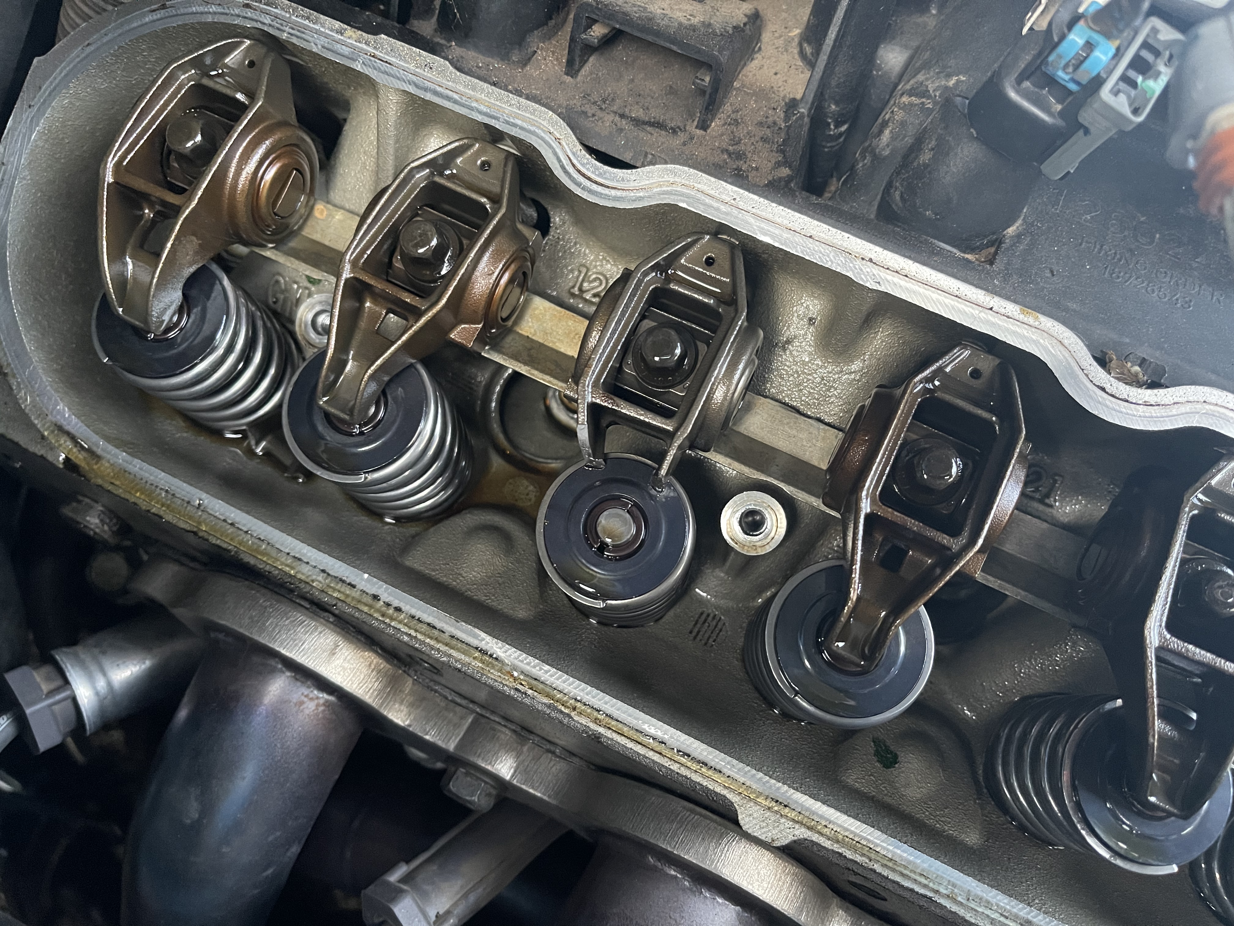

Me: did you over rev it? Owner: no way, it doesn't go past the limiter. Me: FFS :think:

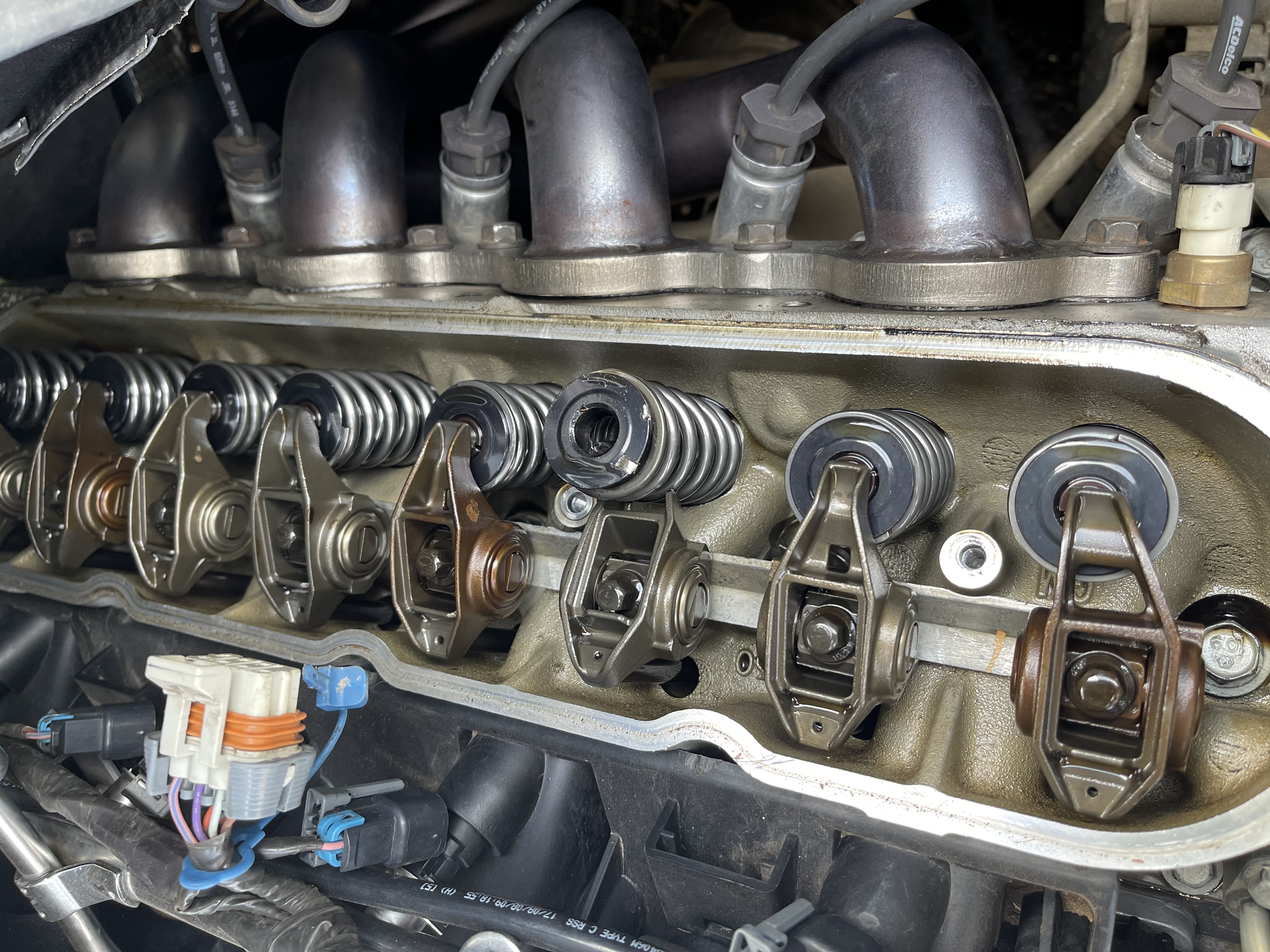

I thought everyone went with doubles so it wouldn't drop the valve...

I'm sure that valve has gone to make love with a piston.

Looks like the rocker broke and what stub of it was left hit the retainer and popped the collets out.

Don't forget to change the engine oil in the cooling system. :thumbup:

To clarify, the rockers are both broken with bent/broken valves below them.
The valve that came loose is missing the head of the valve as I can pull the stem to the bottom of the guide... :?
