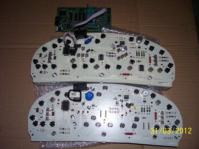

Care to point me in the right direction of the crystal?madmn wrote:I guess i'm going to have to give this a go but, in the mean time since i don't have a VT cluster, can someone short the resonator crystal and then try to write to the eeprom without powering the cluster it self.
i think this maybe be the cause of the timing issues

what's happened to all to board pics of the VT clusters!! i can't find any
it's usually silver and not too far from the MCU, it has 2 pins

Page 13?? I am more than happy to give it a crack if I know what to look for

thanks , it's just under the socket

Not sure if the other guys know, but what needs to be done to short the resonator crystal?
Re: VT-VX Clusters
just joint the two pins of it.
hopefully its off the PCB a bit and you can probably get some tie wire around the bottom of it to link to two ?

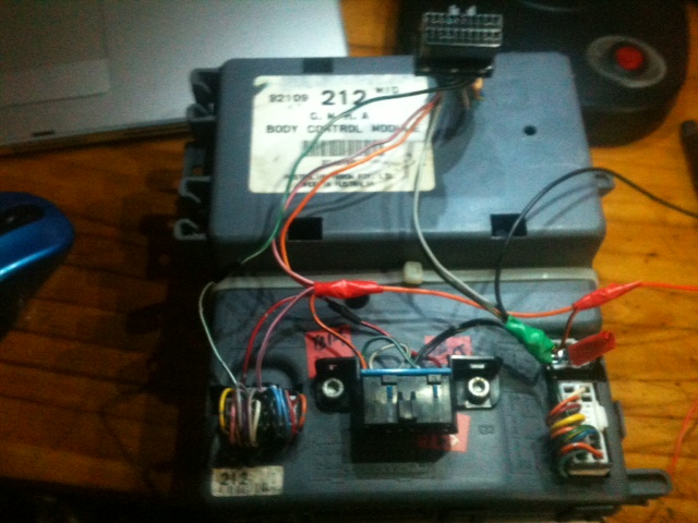

anyway my test bench is fully working just plug in a VT VX and program with a Tech2

Well went to attempt, then thought I broke the cluster since could no longer communicate over comms! So still am to crack open the cluster again to try out. Although I dont think thatll be enough, could just be the limitation of the programmers were using.
Remember reading in the VS programming thread that noone could read/write on board. Although there is one bloke who can.. but is using the top of the line programmer at $500+... will see if I cant find that post and what it was.
Your test bench is looking alright! Least its plug and play. Iv directly soldered onto the pins due to a lack of any floppy cables lying around.
