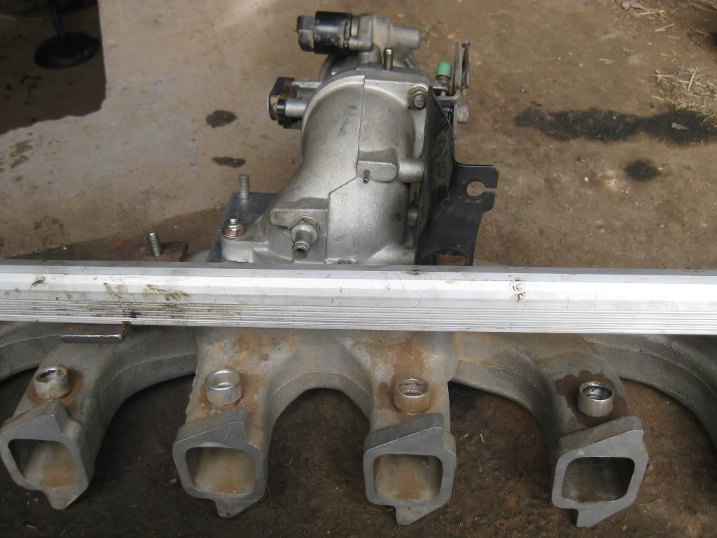

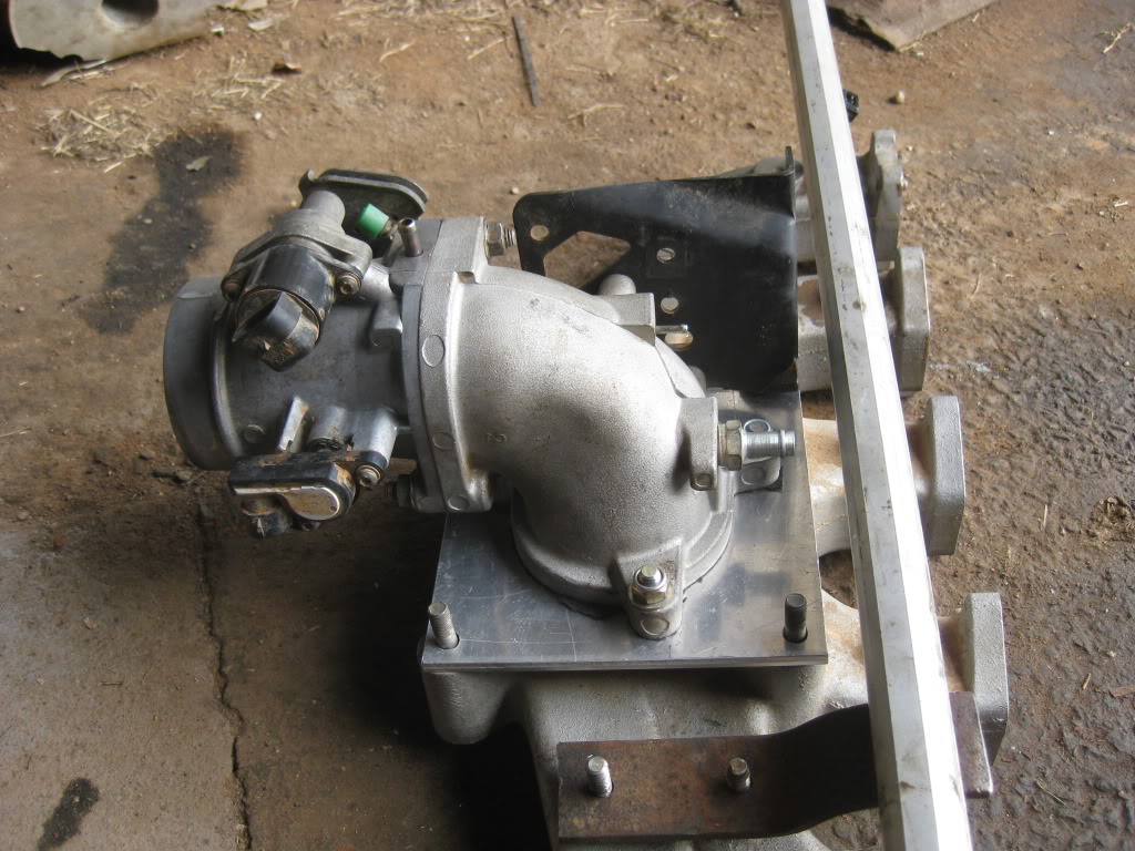

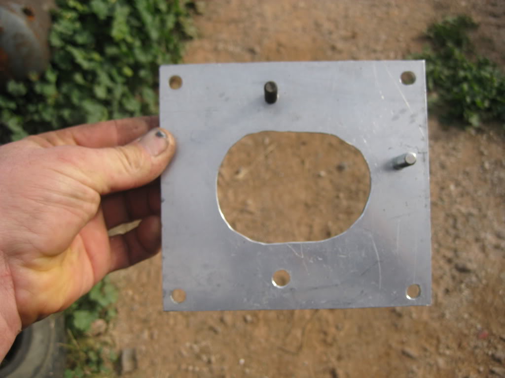

i've done a bit more work on this today. tidied up the adaptor from the elbow to the manifold. got it all bolted up. cleaned up the elbow and throttle body. the tb was filthy ! it had a heap of oil and dirt all through it. pulled off the iac motor and tps then went to town with some degreaser. hopefully this will give it a fighting chance at idling smoothly. the only real drama i have with this setup is using 6mm plate to make the adaptor. 10mm probably would have been better. we'll see.
picture of it mounted.
plenty of clearance for the throttle cable.
Re: fuel rail clamping. how much is enough ?
i'd put a smeer of silastic or something similar around the adaptor plate just to make sure if there is any flex in it that it will still seal!
looks like your making good progress anyways
