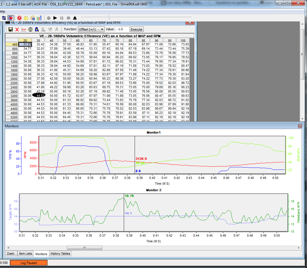

So I took the car out for another blocky and the current tables are lean all over, so i have crept up on the inj flow rate and it's currently sitting at 0.1104. I took a log of the last drive and it looks to me to be somewhere around the mark. There are still studders and spikes and the idle is way higher than before but I can actually put some load on the motor without it cracking and farting. You can see in the log I held the brake in 2nd and tried to put a few rev's in under load.
So from here should I be still looking for anything else before I start playing with the VE tables? or do you guy's recon I still have a setting wrong or the injector rate is still a little on the lean side.

watching the log over and over I think I still need more fuel across the board, maybe even some AE.....? true?

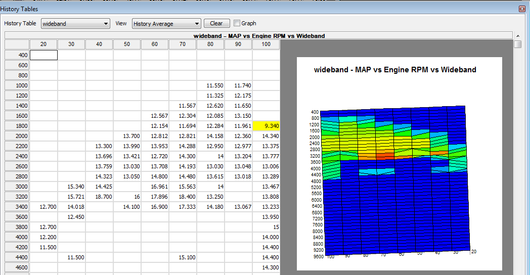

I wouldnt say you need fuel across the board, mainly around 60/70kpa 2800->3600 RPM and 20/30 kpa @ 3200,3600 rpm to fix those lean spikes as you cross that area. (the snapshot on the right hand side is from with the 'graph' checkbox selected, and 3d graph rotated to look 2d (click on the graph, hold down ctrl and use the arrow keys). This makes it easier to see whats what, and cut n pasted in to this pic for illustration).
wideband history average.png (43.31 KiB) Viewed 5511 times
To make things easyer to interpret Ive also got the wideband and target AFR range set to 10->20 in the adx.
setting up wideband display.png (63.48 KiB) Viewed 5511 times
Also, if you have not enabled data tracing, that helps when replaying logs to see where the ecu is getting the data in realtime.
lean at 30kpa 3200rpm.png (106.12 KiB) Viewed 5511 times
