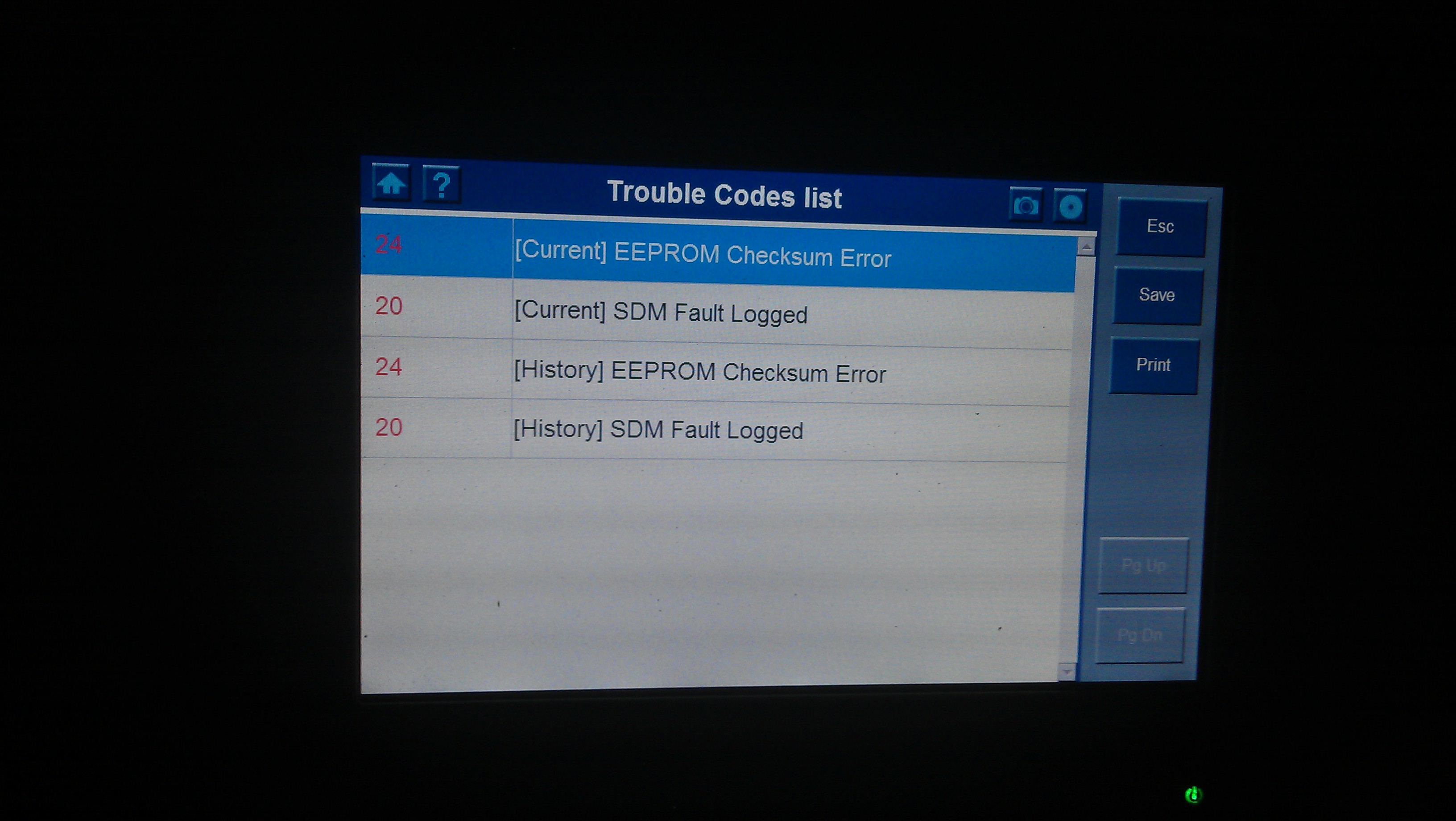

Yep sounds like hes messed something up pretty good. If the revs are sitting around 2K, then its been programmed as a V8 instead of a V6, Or some weird number has been programmed in due to a failed programming sequence.
Must have really screwed up to do all that!. Id suggest to get him to check the airbag config, change that first. Then configure the Engine size (will fix rpms) then reprogram the fuel settings as a sedan. Also make sure that its on the correct car eg 02 VX ect not VT or something alike!
Should be able to fix it with the scantool.. unless theres been a major screwup!
Need help with VX S1 V6 - Error Code 24 and 20

These are the results so far
20:27:09.953 Tx'd Frame = FB, 57, 1, 2, AB,
20:27:09.984 Rx'd Frame = FB, 62, 1, 2, 0, 0, 0, 0, 0, 0, 0, 0, 0, 0, 0, A0,

Means no "current" faults present. How about sending FB,57,01,04,A9, will request "History" faultsdmenace wrote:These are the results so far

Ok will do that.Tazzi wrote:Means no "current" faults present. How about sending FB,57,01,04,A9, will request "History" faults
I don't get any faults on Tunerpro as well.
I've attached a screenshot of the Autel Scantool
