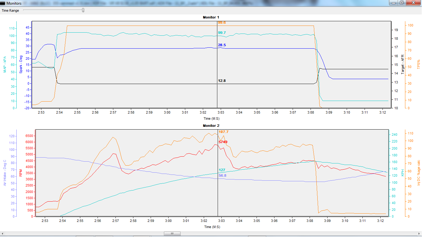

I've attached a screen shot of a run at the fathers day drags. 1st gear the revs rise very cleanly with a good clean curve for both RPM and injector DC, at the start of the 2nd gear both RPM and DC curves become very jagged which could well be possible if fuel flow/volume was an issue. :hmm:
Red = RPM, orange = Calculated injector DC

id say right about 3:01.5 you peaked them out and they went static from pulse. Depending on injectors depends on how much you can stretch them till they go static, EV14 or new style injectors alot of them can go right to 98/99% before going static where as EV1/6 are 90-93%

They are super 6 injectors. Not 100% exactly which version but will be EV1/6 type injector.
Thing is, no way should this engine be getting this close to maxing injectors. Their is enough injector to support 430hp @ 80% DC if I have my numbers correct but in it's current configuration it's not even making 400hp.
