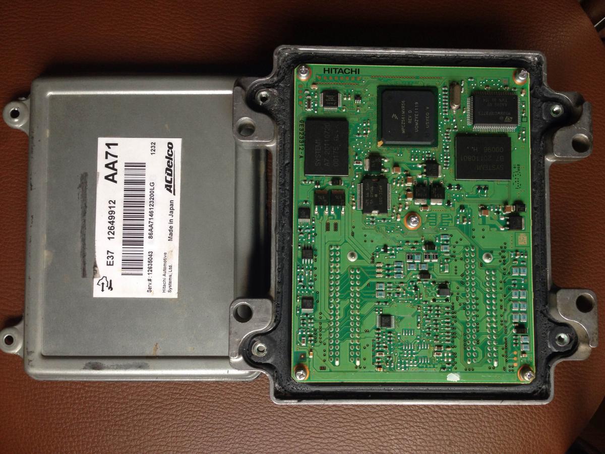

- FriskyDingo
- Posts: 38
- Joined: Wed May 19, 2021 6:11 am
Re: E37 Ecu
If you get the seedkey figured out could power pcm flasher be used to read and write these ecu's?ironduke wrote:I now have myself a bench E37 to play with, way things are going it's at the bottom of my list but I've got it!!!

- FriskyDingo
- Posts: 38
Re: E37 Ecu
I managed to find this picture of an E37 not sure how much help it is.ironduke wrote:I have very serious doubts that the kernel written for the E38 and E67 ecu would work with the E37 ecu.. I do not have the knowledge of the internals but I doubt they are close enough to work, I think if they were it would have already been discussed at length..FriskyDingo wrote:If you get the seedkey figured out could power pcm flasher be used to read and write these ecu's?ironduke wrote:I now have myself a bench E37 to play with, way things are going it's at the bottom of my list but I've got it!!!
- FriskyDingo
- Posts: 38
Re: E37 Ecu
Here's a better pic.
- post-3884-0-34906400-1441357336.jpg (175.79 KiB) Viewed 6207 times
Re: E37 Ecu
that looks very similar inside to my E83 ....
