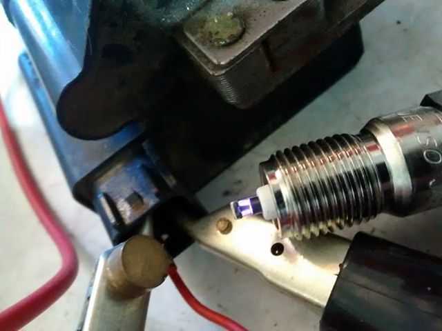

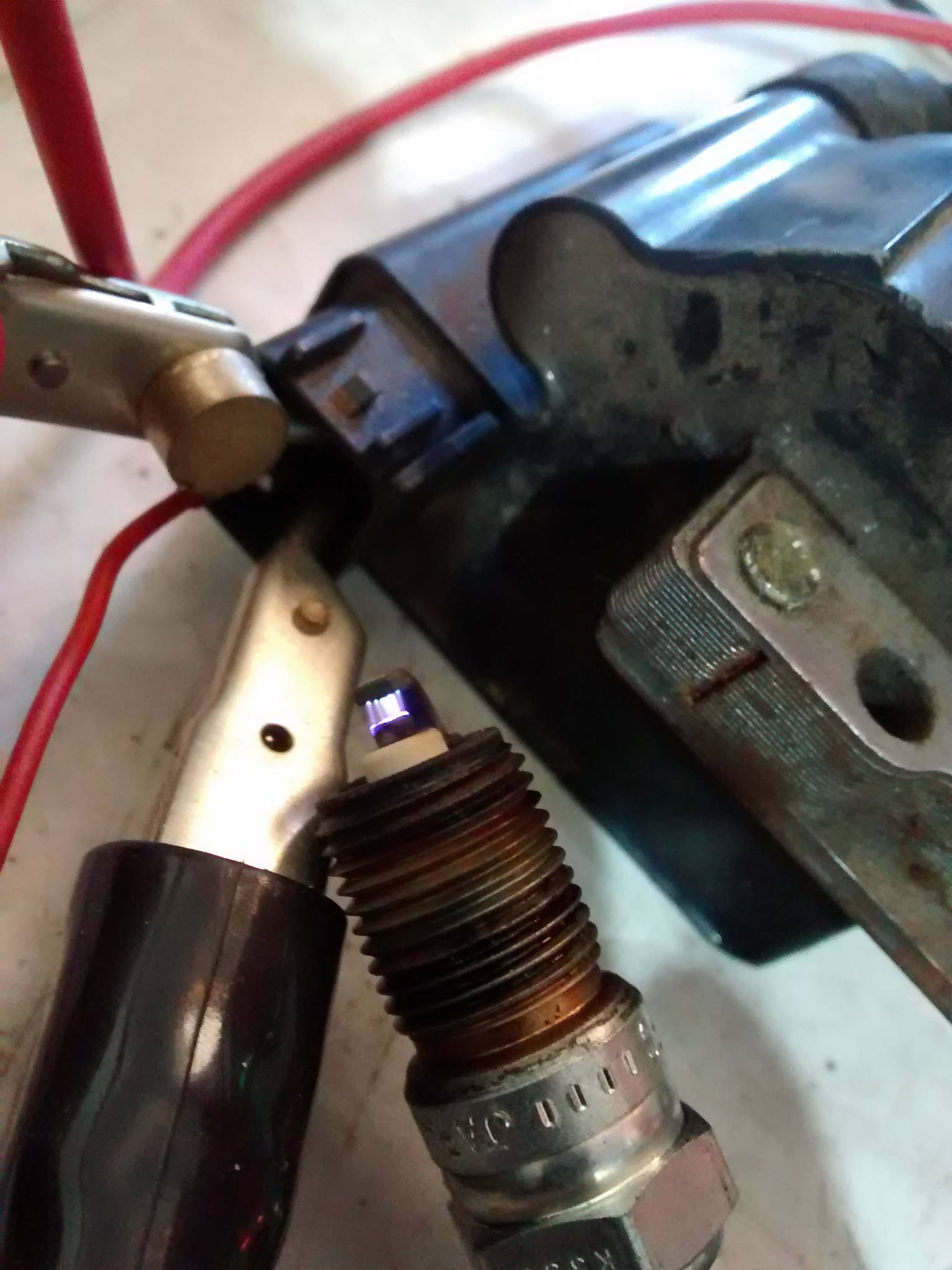

Not enough boost lol. Dunno about autolite, ive tried bosch super 4 before, no change as it's only providing different paths to earth, i think those would maybe help with weaker spark systems but it's mainly providing longer life like iridium by wearing multiple contact points, I got a cheap set of Brisk spark plugs once, i didn't notice any different in results logged but maybe 1 degree of timing if i was lucky. Ive just put in new plugs in mine and denso have V Groove copper plugs, if you get stock ecotec genuine holden plugs these are what they sell now also. On the bench you can see the spark loves having the gap in the middle and makes 2 arcs vs stock spark which is all broken up into tiny little sparks, i dont know if this is good or bad i havn't noticed any difference atm from testing.

see how they go then, would be interesting to see the spark jump vs stock and v groove.
