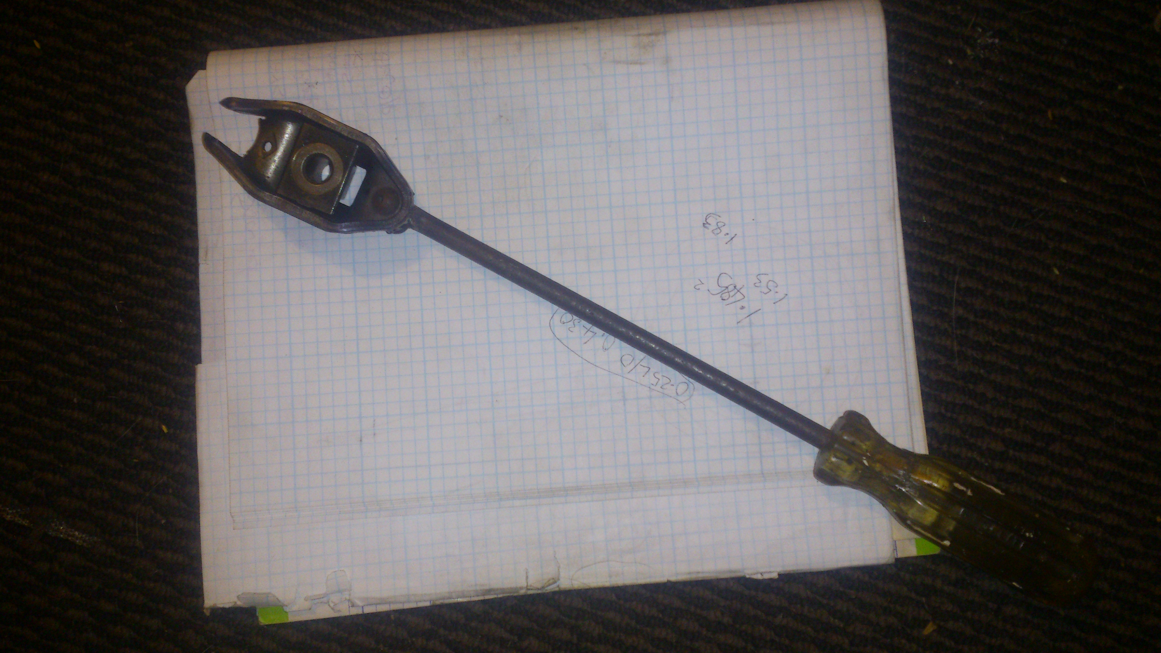

I'm thinking of making something like this (random ebay pic) as it seems like it would be the easiest to use.
It might not be a piece of angle iron but it's close enough
I think this is what you might have been referring to in the earlier post?
Yep, with about 50cm bar on that you'll have good leverage.
yep same as that with a bar on it is what I've used in the past to get collects out.

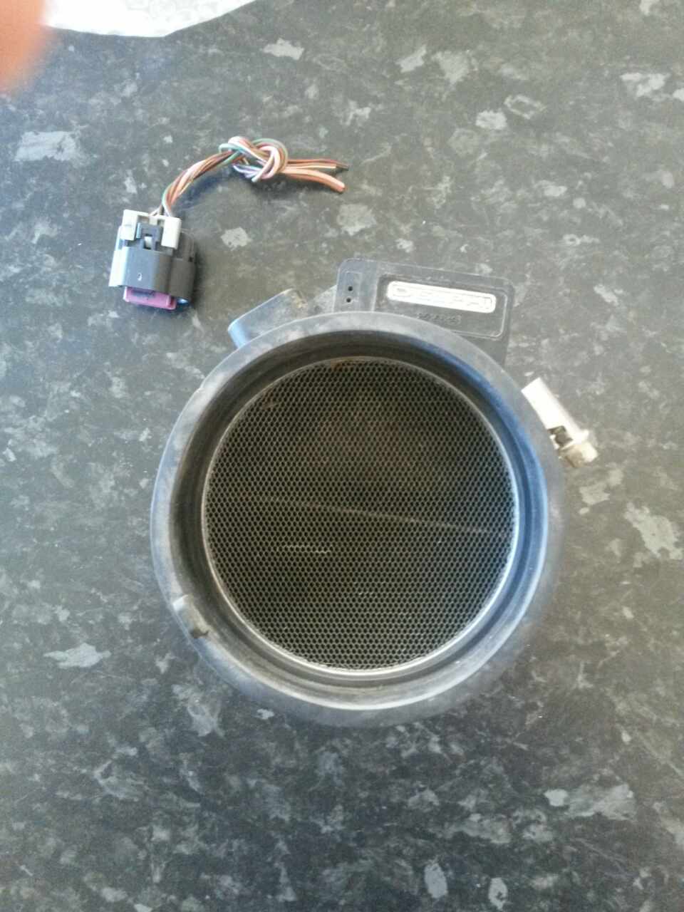

One of santa's little helpers left this in the mailbox for me today.
Now to accumulate all the bits to make it fit.

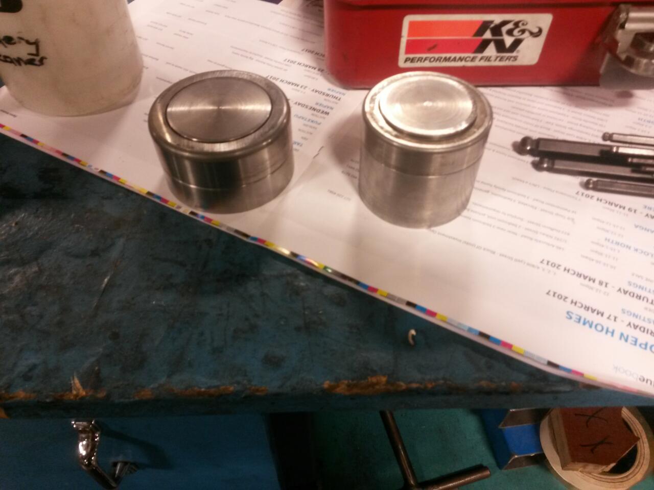

Also had a bit of time last night on the lathe. Should make pressing the bearing cups in a bit easier.
Cheers Dylan
It'll be interesting to see the results of the larger AFM
