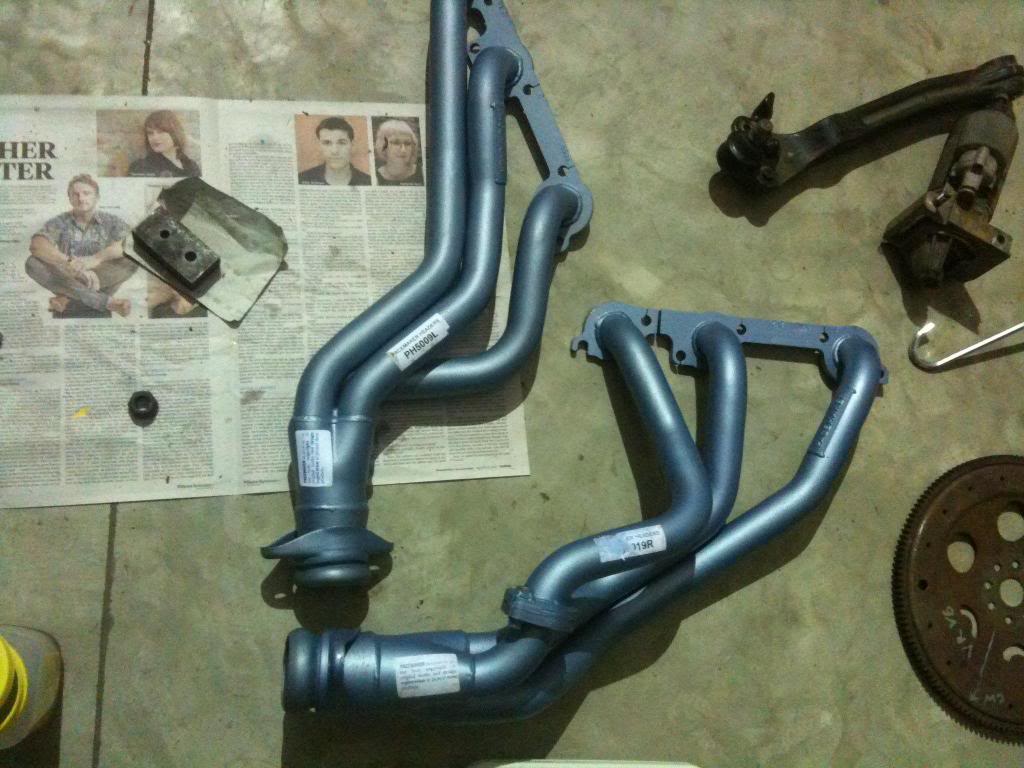

Are you getting a full exhaust? Tein hi flow cats 2.5" system etc
- Posts: 8601
yep, mandrel bend 2.5" and higher flow cat, legal one, 200cpi or more.

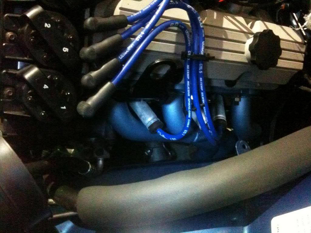

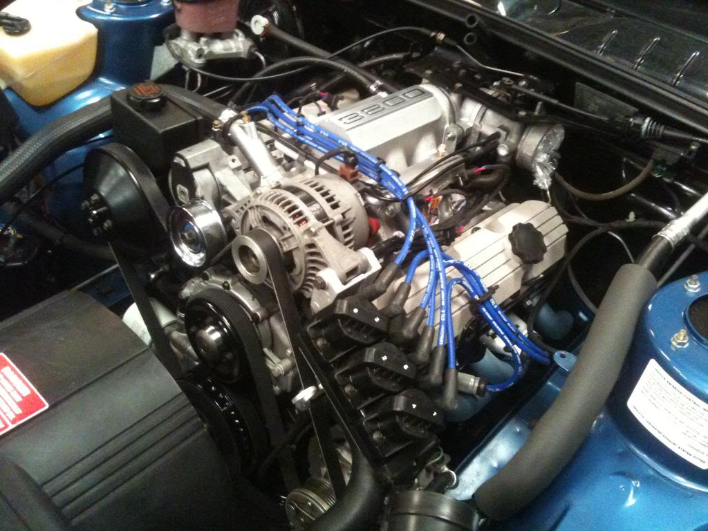

- Posts: 8601
Finally some sunny days as of recently.
Enough to get a good look of the progress, engine looks a million bucks
yesterday I did the best hand wheel alignment job I could and lock in the tie rods at that. Slight toe in (measured about 3-4mm) , and roughly centralized steering.
PS rack all sorted, hoses done and DXIII filled. Coolant done about a week ago, no leaks, shouldn't be any as I had it all running when I did the major gaskets. Only thing different this time is the timing cover and water pump but I sealed those to the best of my previously experiences and little tricks I learned in the past. Also sorted out my WB wiring. I made it plug and play but using a faulty O2 sensor's socket, removed the wires and soldered in the WB, extra green wire with single way plug goes to the cabin where it plugs into the harness near the ECU. I just hang the wire though the door and close it in there. Works just fine
- Posts: 3364
- cars: VR Commodore V8
Should be good, do the V6's like twin cat set up's? I've always ran them on V8'svlad01 wrote:yep, mandrel bend 2.5" and higher flow cat, legal one, 200cpi or more.
