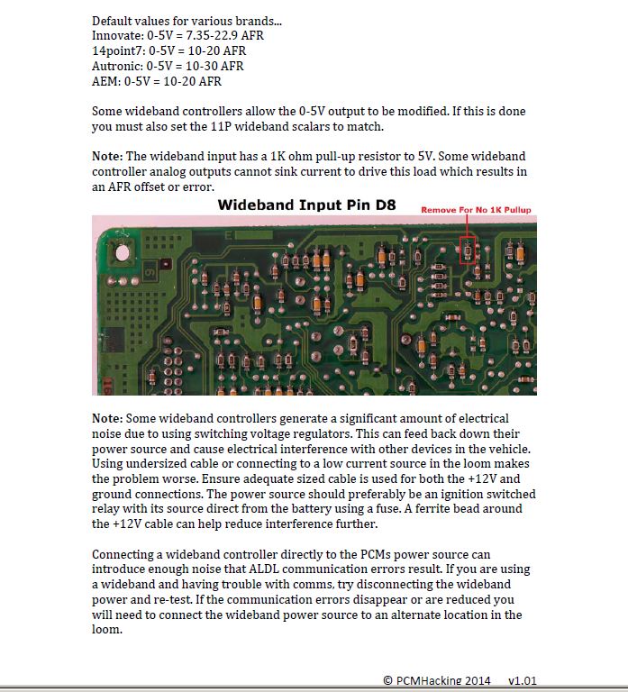

page 11 of the $11P manual has your answers!

http://pcmhacking.net/forums/viewtopic.php?f=27&t=3798
the pdf is inside the 11P zip file.

well there you go. thanks for that.
there's ya problem. 1k pull up explains everything.
