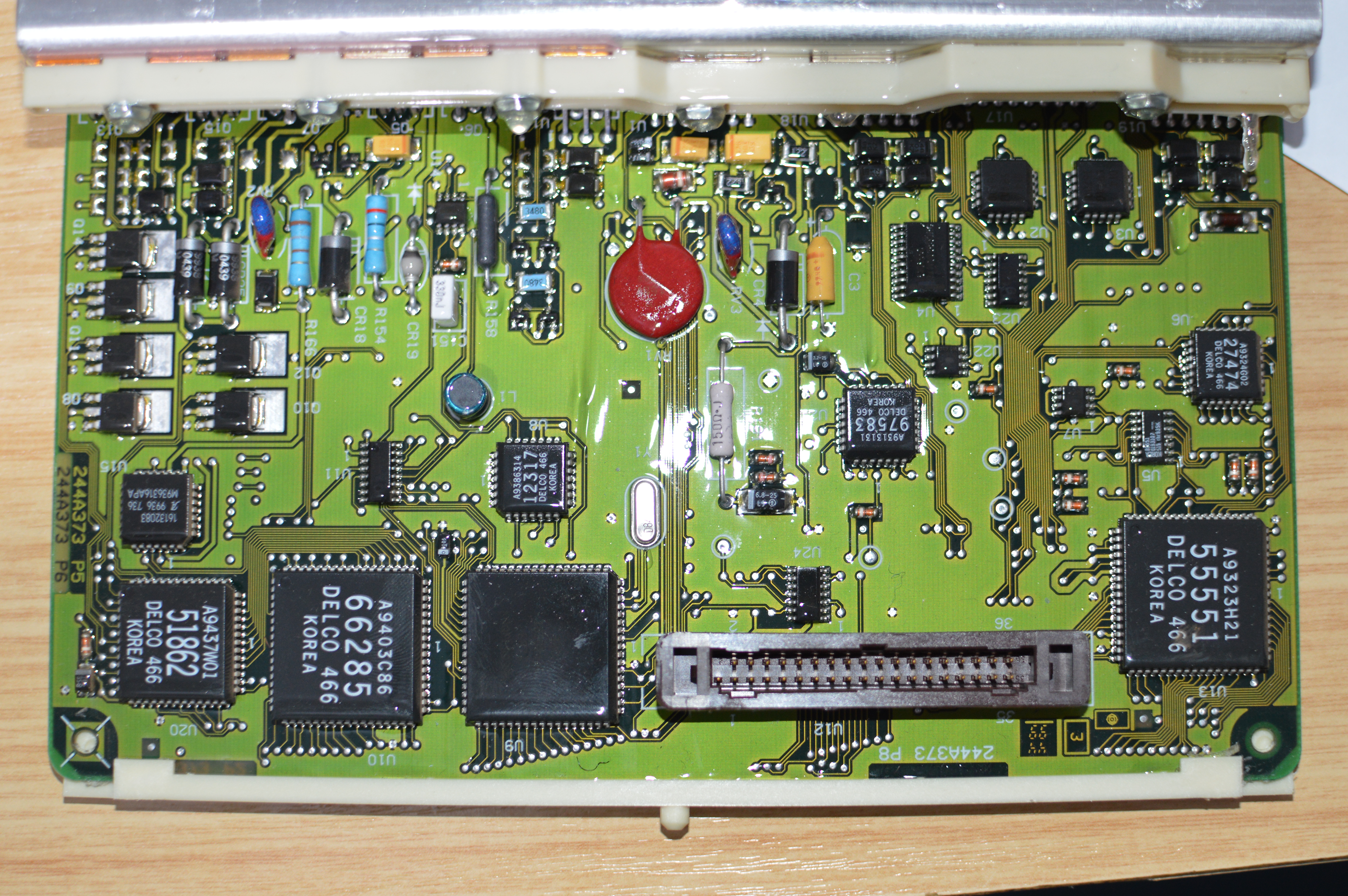

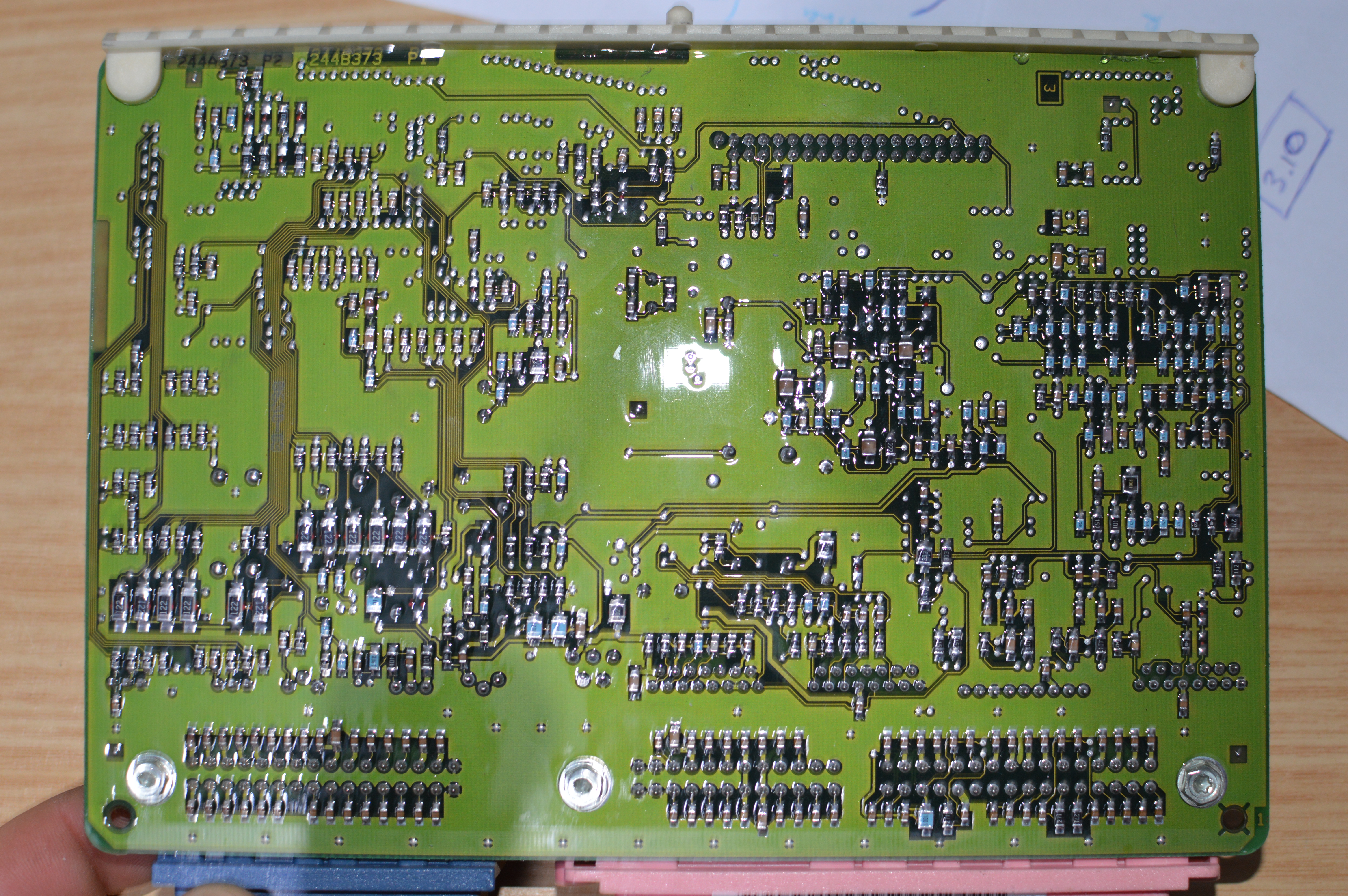

hope these are ok for you from a vs s3 auto 5l

Haha ok my mind must have been playing tricks on me. they are pretty much identical where it counts. some of the flyback diodes are configured differently but i they are for different outputs
Posts: 4853
Re: Sequential injection
only change i can see between V6 and V8 is the two diodes at Q15 and Q13 which arn't there on V8 and the Blue Resistor which is there on V8 and not on V6 on the back just above the pink connector. Dazza can you see the value of it?

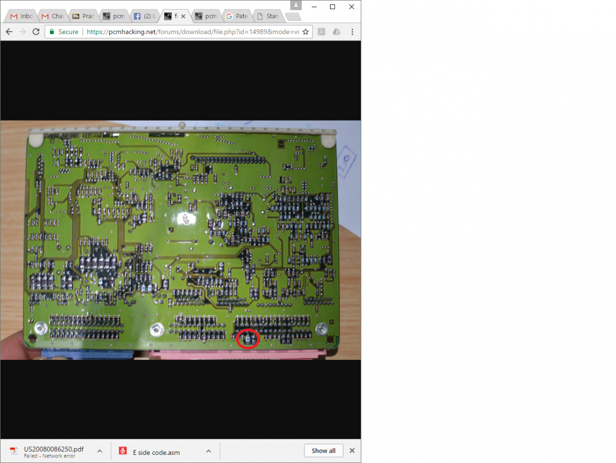

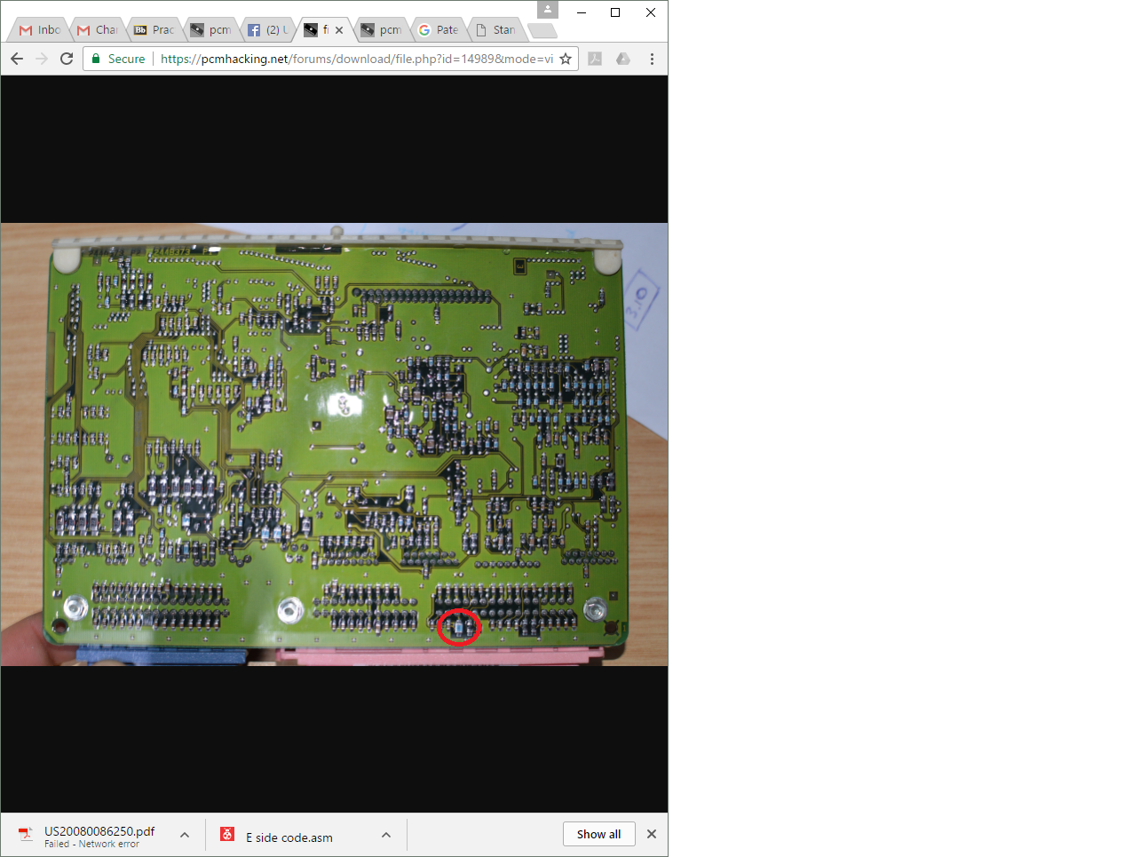

which resistor are you looking at i couldnt find the v6 images

Dazza92VP wrote:which resistor are you looking at i couldnt find the v6 images
This resistor is not populated on a 396
