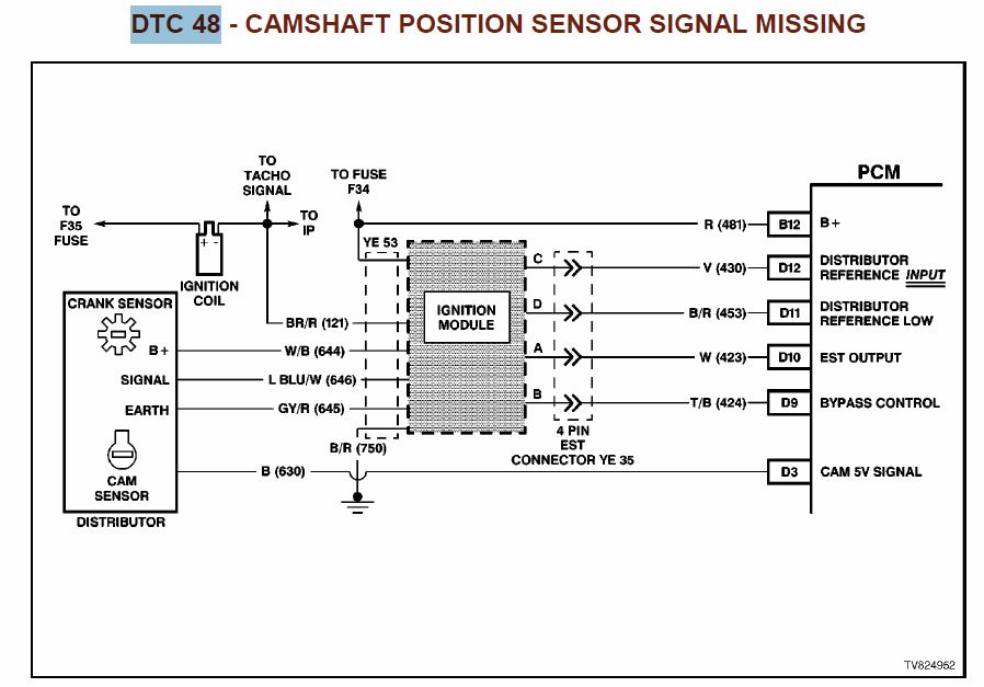

sorry didn't read it properly, VT V8 5L was MAF and Sequential, it has Cam Signal, So VT V8 Enhanced Code on a VT V6 or V8 PCM would work.

V6 ecus only have 6 injector drivers so had to be v8 ecu

To run an aftermarket comp to run fuel only could I fab up a chopper wheel onto the harmonic balancer and use a pickup to control sequential injection ?
