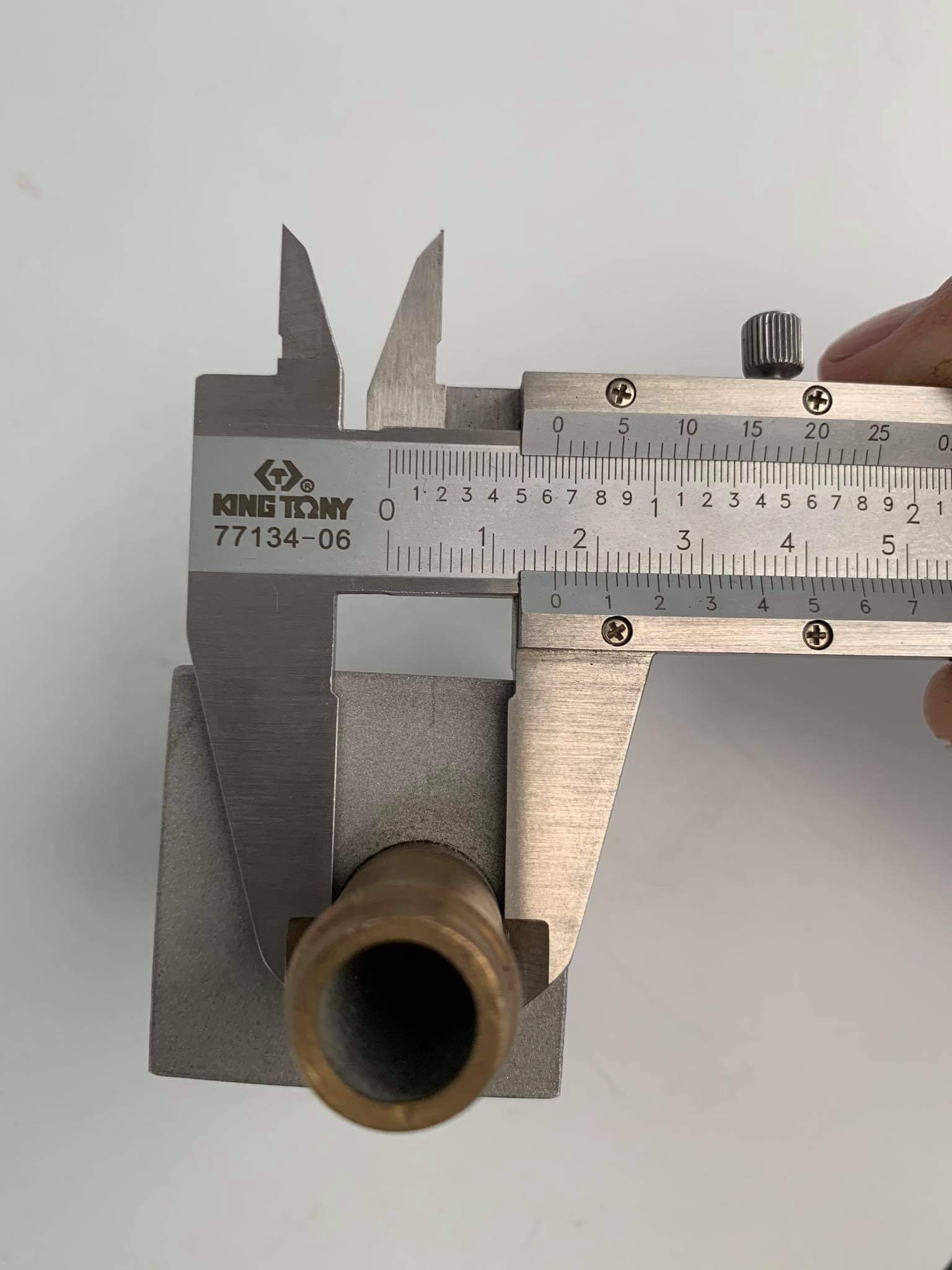

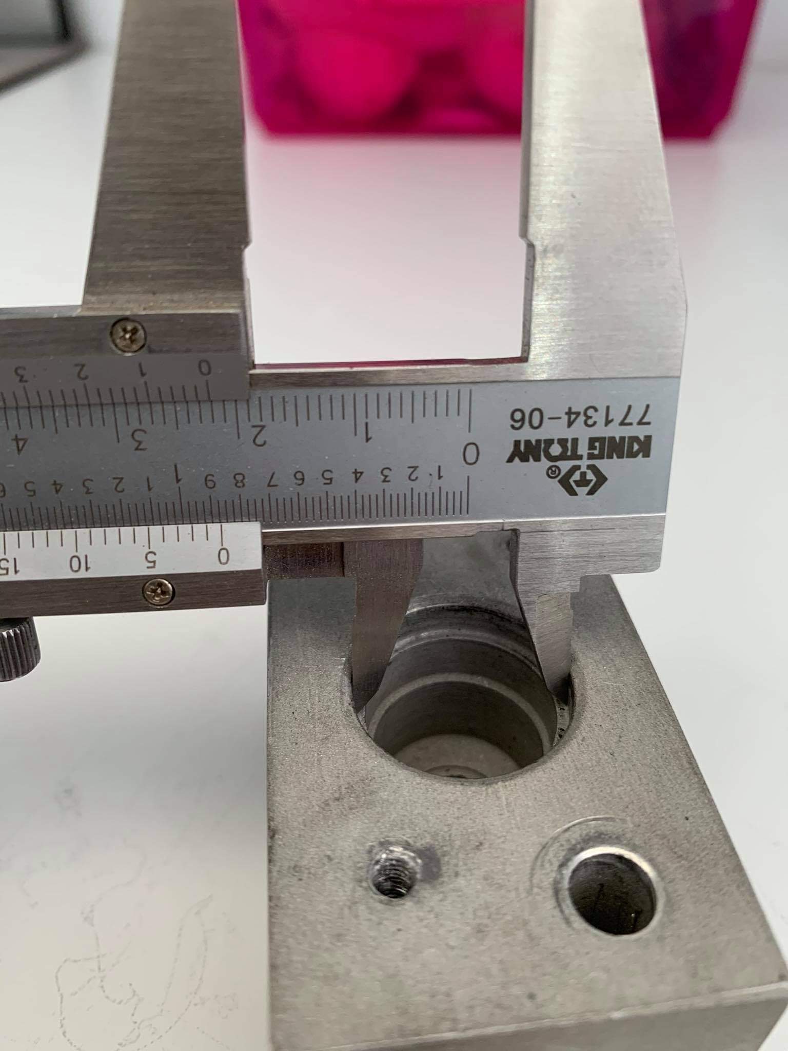

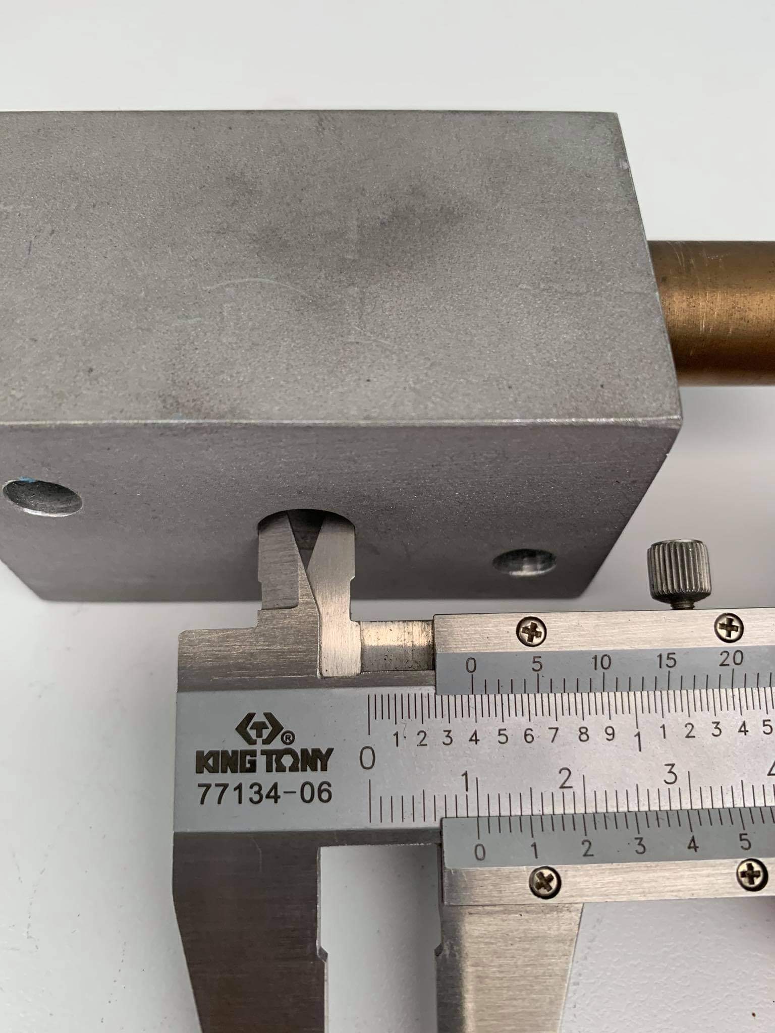

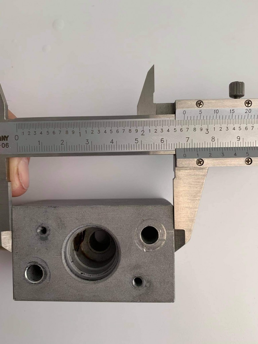

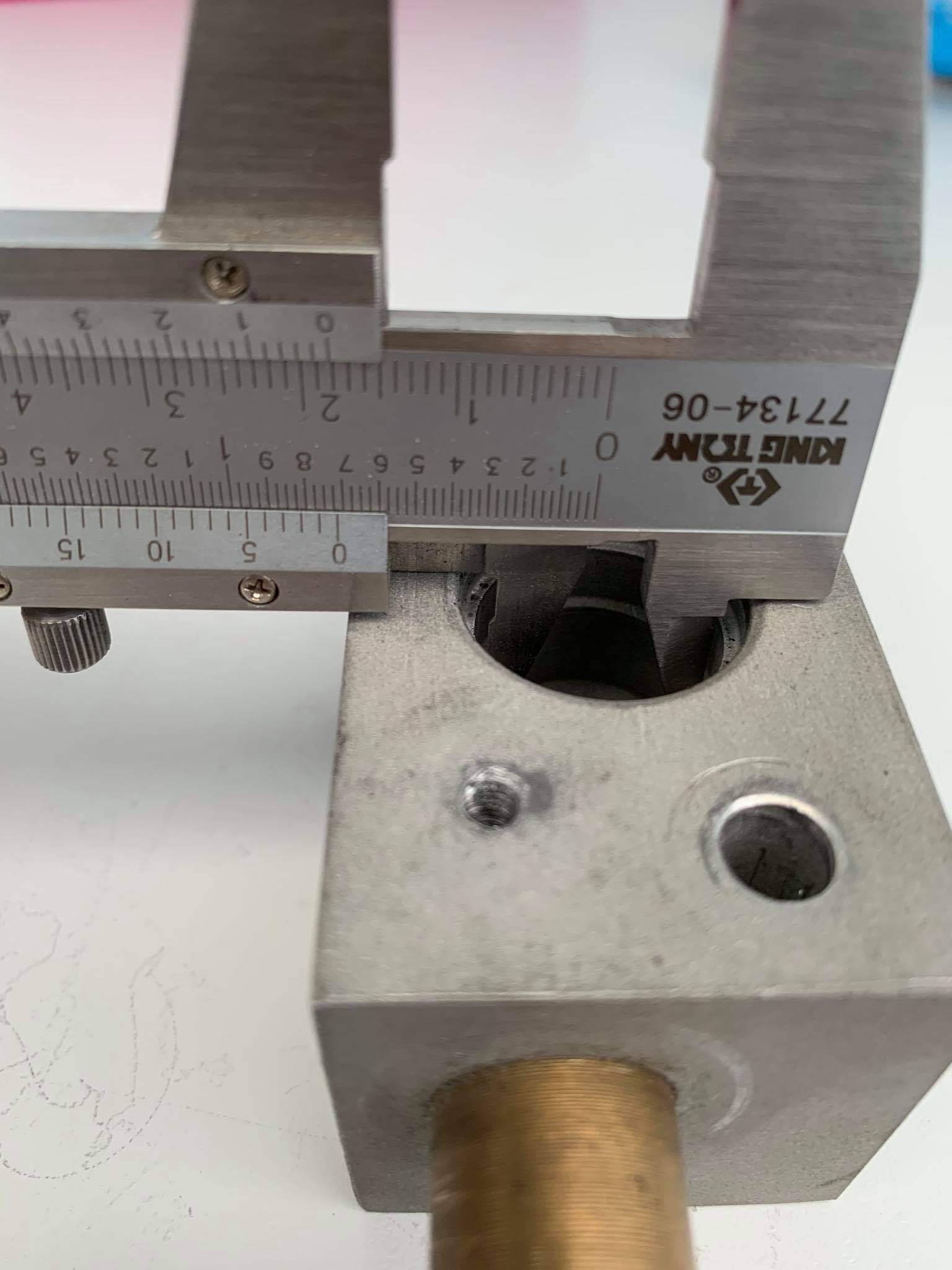

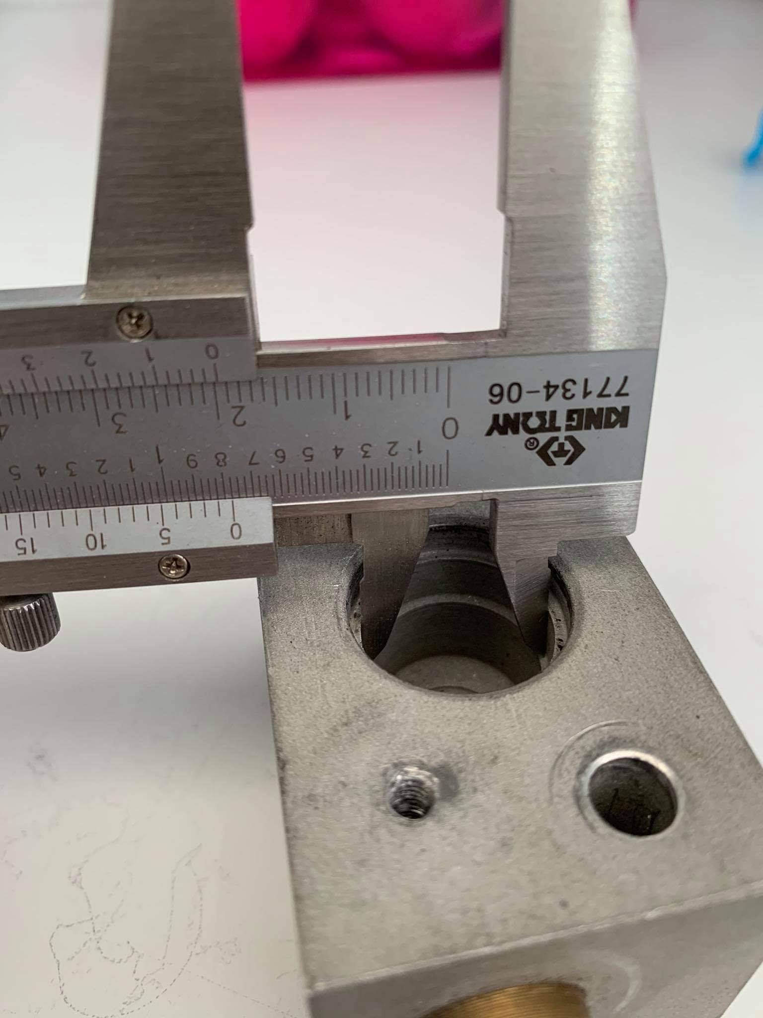

Re: VL Walkinshaw High Idle Issue
Measurements. I haven’t got a I.D measurement for the inlet pipe I just realised.
'quipt4it
- Posts: 675
It looks like you can either block the air going in, or the air exiting the block. Maybe work on the exit. 10mm looks ideal. Get a piece of al. round stock, cut it short enough so it doesn't foul the end of the pintle and so it just tucks inside the mounting face to the manifold. Then just dial in with a drill bit how much air you need to bleed in. Actually, the shorter the better, less drilling lol. Plus you want to loctite and stake it in. Plus for added insurance, make the gasket diameter smaller than 10mm.
