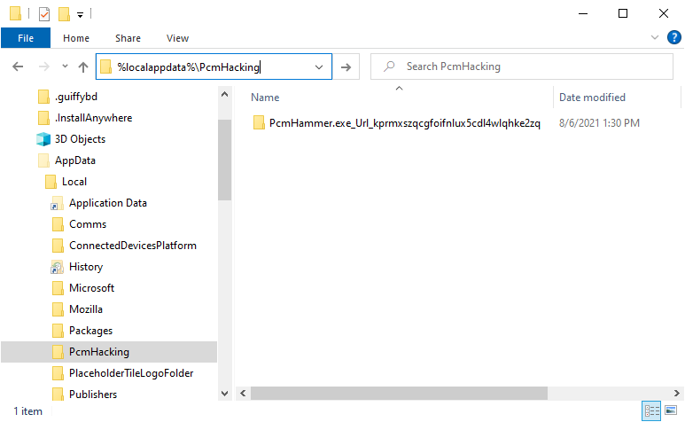

Cincinnatus wrote:Found localappdata and there is no pcmhacking in it, even in subfolders
Then maybe you didn't find the right location ...
Are you typing in this exact line,
%localappdata%\PcmHacking
percent symbols as well ??
That should show a folder on the right side of the screen that starts with,
PcmHammer.exe_Url
File Explorer view ...

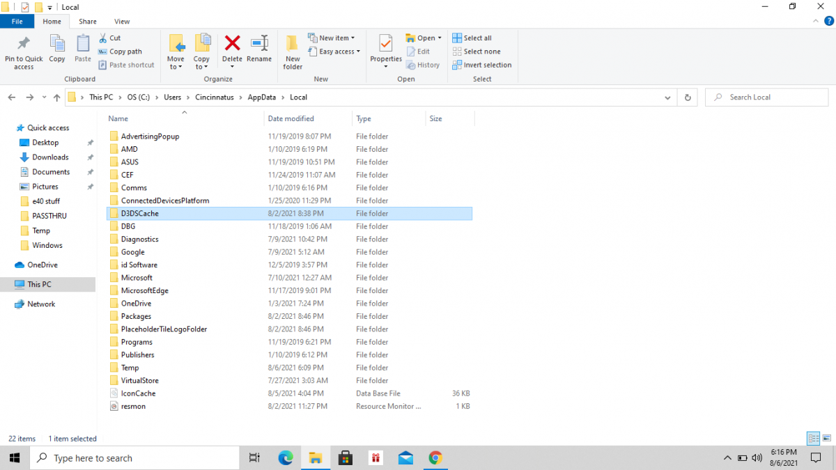

you mean here?
it's not there as you can see. I just wanted to post this before i try the other file you sent me. i'm thinking the app store installs it in a way that is causing the problem. will report soon. i don't always have internet for this pc to try things quickly.

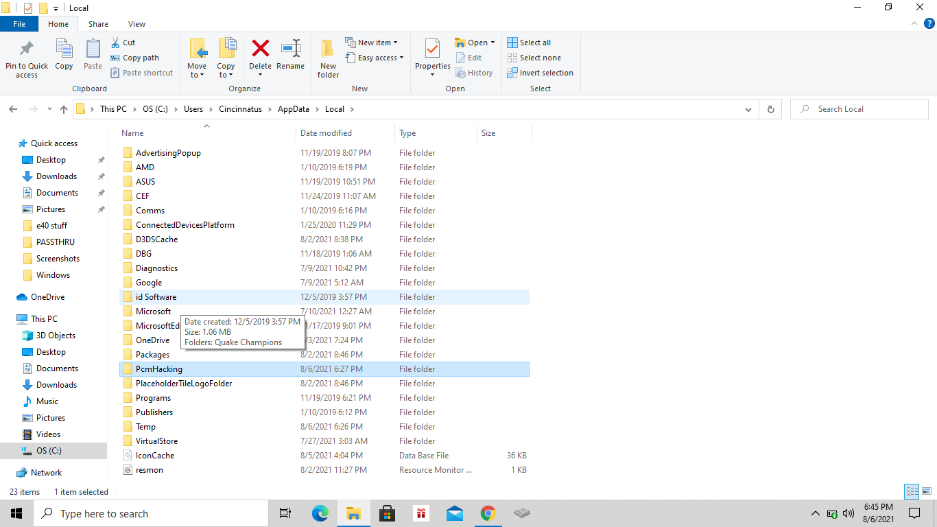

The pcmhacking folder exists in appdata/local now after installing the program directly
app store issue or windows issue...either way didn't work for me. Thanks again!!!

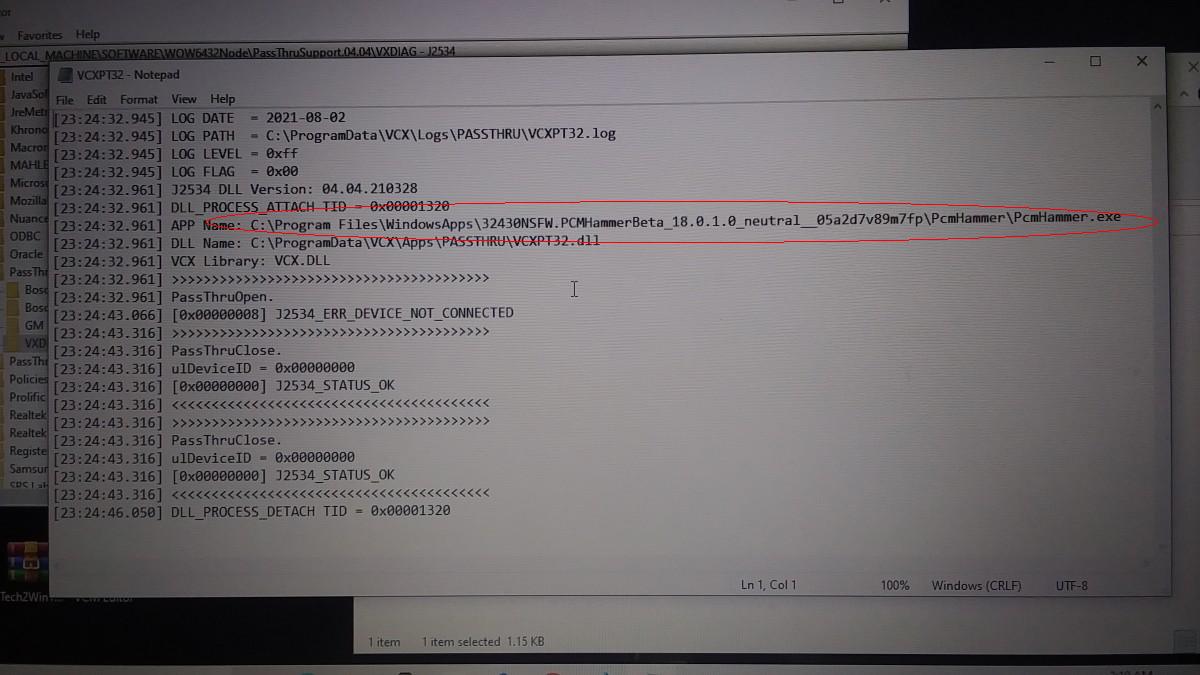

That explains something else to me as well, this path,
it's been bugging me.
Somebody needs to look into that AppStore installation, I cannot imagine you are the only one with issues, bothers me even more to think others may be having the issue and are not saying anything about it.

They are definitely _hiding_ PcmHammer (apparently all MS Store Apps) in \Program files\WindowsApps, and wrapping it with a security blanket.
It seems that PCMHammers Settings location is under
%localappdata%\Packages\32430NSFW.PCMHammer_*\LocalCache\Local\PcmHacking
It seems that PCMHammers Content Cache is under
%localappdata%\Packages\32430NSFW.PCMHammer_*\LocalCache\Roaming\PcmHacking
Uninstalling PCMHammer does remove the above locations and data.
