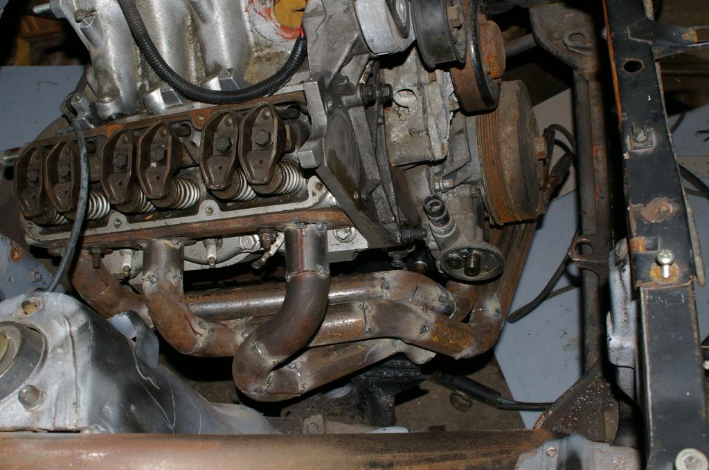

all messing round LOL about to go start more cutting 10 pack of discs will last this project out
Posts: 5630
Re: DELCOS NEW RIDE
im starting to wonder if ive taken it too far LOL they look long as fuck
Re: DELCOS NEW RIDE
yeah could be getting excessive :P

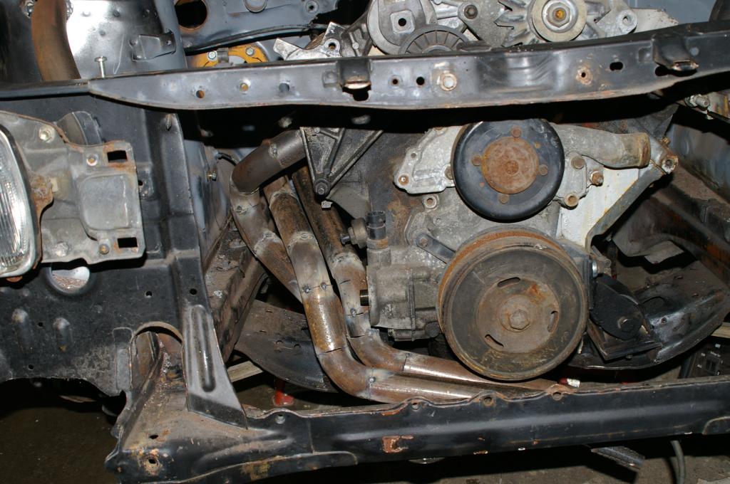

Might want to look at getting them ceramic coated internally to keep the heat in the exhaust gas and out of your engine bay

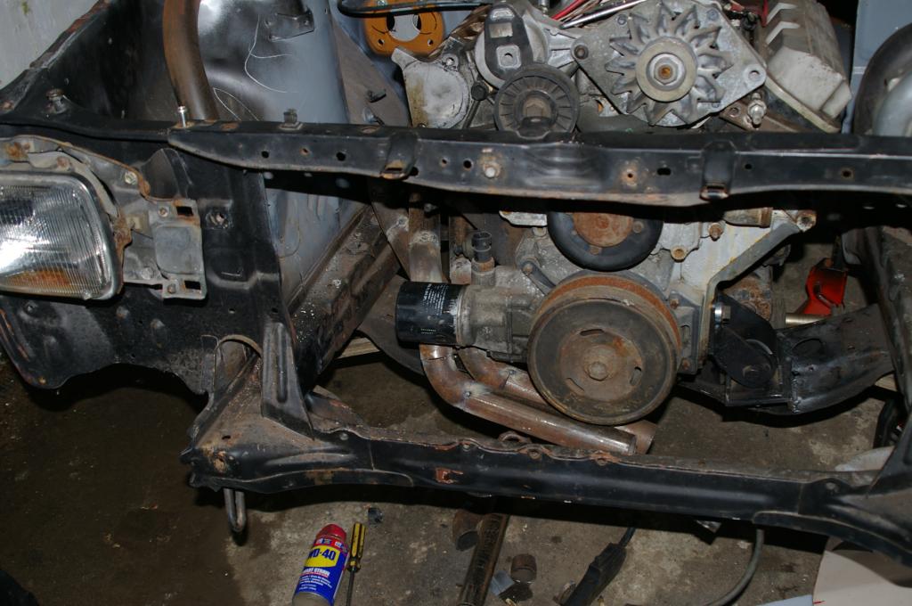

LOL, why you aiming for 38" long primaries? Are you going to attempt to do the same on the other side?
Posts: 5630
Re: DELCOS NEW RIDE
i sort of calculated that to be the right length but could get away with anywhere from 30-40 inches.the other side will be exactly the same length :P guess i wont know until it runs down the street worst come to worst i can cut the last 6"s off and refit a collector and retest to see what works best.in the end i think its probably going to need bigger primaries and maybe shorter at the same time
Posts: 5630
Re: DELCOS NEW RIDE
the longer the header the more compression and timing you can run due to less reversion. i should probably just make a short version that collects before the oil filter and it would probably make another 100hp on the VB setup
charlay86
Posts: 584
cars: VT S1 SS (L67)
Re: DELCOS NEW RIDE
Post by charlay86 »
Could always make stepped primaries.
Keep the existing pipe size at the cyl head, and then step up to the next size of tube at 15-18" along
Posts: 5630
Re: DELCOS NEW RIDE
i just dont really want to run long secondary pipes of a bigger diameter ill try the header as is and see how she goes
Re: DELCOS NEW RIDE
what size primary are you using ?
