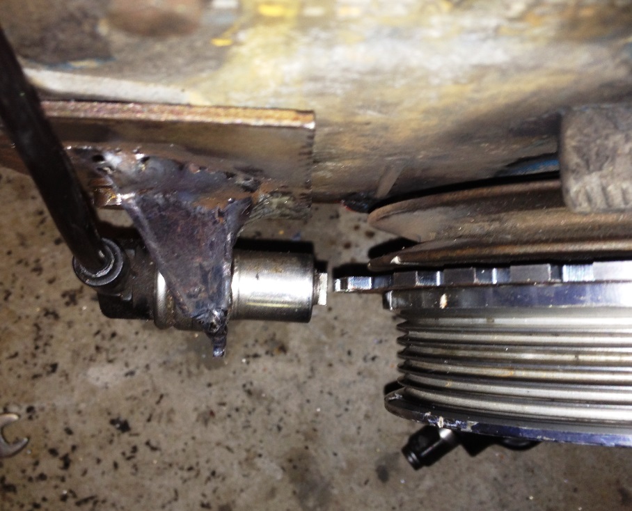

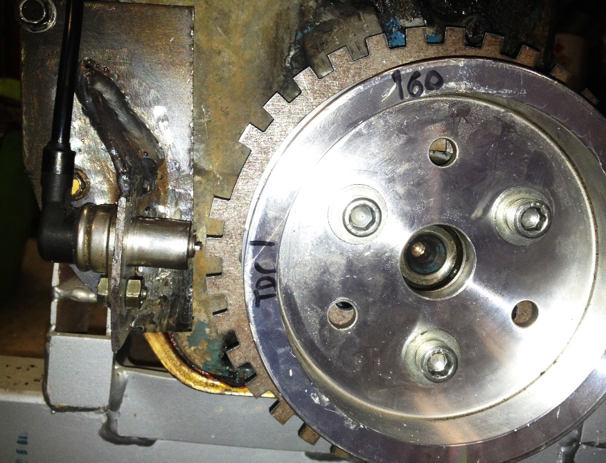

well had some more progress on this, needed to finish mounting and locating the new trigger in the right spot relative to TDC etc and also needed to re-make the crank trigger bracket in the right spot so that has now all been done!
without precisely timing everything i'm thinking its going to be about 65 degrees reference angle !!
Another step closer to a dizzyless 6 coil 202

THAT IS FRIGGEN COOL! Nice work keep us updated!
