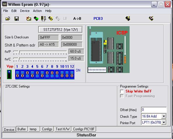

Jayme, I tried to erase as shown above,with no luck :thumbdown: .Looked around on line & found a pic of how to set the jumpers(that are beside the ZIF socket). It worked with both the chips that needed erasing. :thumbup:
SST512SF512 Burn
SST512SF512 Burn
SST27sf512 Erase
SST27sf512 Erase

so what you have to change the jumpers halfway through the erase ?
Posts: 5626
Re: More Willem Programer help
mine has an 27sf erase button accross the top instead of jumpers but they sometimes dont get the required current and still needs the wire on some burners its the cheats way :mrgreen: if all else fails the jumper doesnt LOL

I moved the jumper, then hit erase,then it went through the motions. :thumbup:
