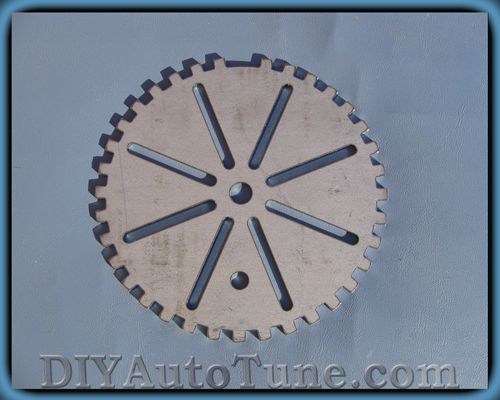

festy wrote:See http://pcmhacking.net/forums/viewtopic. ... t=20#p9230
Sync pulse is 70* after, so 10* after the next 60* reference pulse
thats for a 4 cyilnder... I beleive the OP wants to use this on a 6cyl 202? the 6 cyilnder lines up differently.
In a 6-cylinder application, the evenly spaced notches coincide with TDC. The sync pulse notch coincide with 10° after TDC for the #1 cylinder.

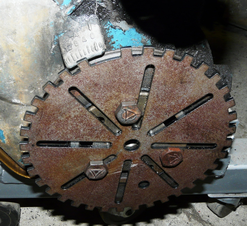

All good now, when I've finished the wheel I'll put up a photo.

this is where I put the holes in mine, may or may not help you at all
I think I ended up getting 6.5 inch wheel from memory ?

I'm sure it's the same as yours so I will have to drill the two other holes but having the crank bolt means I can lock it down before drilling.
Re: Trigger points for CAS.
but if you do 6 + 1 will be different location anyways.

Did you end up marking the wheel so you know which way it go's back on? I mean if you have too take it off so you don't have wind the motor over #1 tdc every time you bolt it back on
with the motor at TDC that missing tooth should be just after the ABS sensor, so theres only one way that will align correctly.
also i have a serpentine pulley on the front of the crank (this trigger wheel is in between it and the balancer) and its got the marks on it, so i just keep it and the chopper wheel together when i remove them so its pretty straight forward.
this picture might be a bit misleading .... the TDC mark is not actually TDC, TDC is the 60 degree mark, i labelled it this way so i knew where TDC was to align the sensor.
