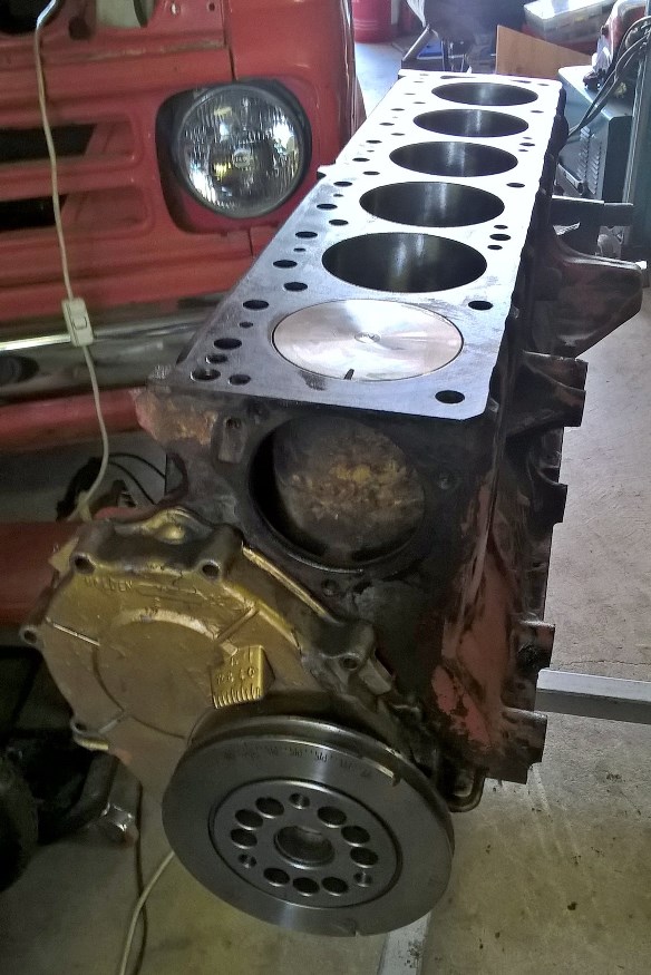

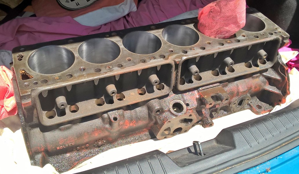

Re: My Delcoed Rides
So picked up the bored block today and got stuck into cleaning the bores and dummying up the crank and a piston, they are approx. .010 out the top of the block, with it like this i'll end up with about 11.5:1 compression, so going to have to machine the tops off the pistons to get it down to 10-10.5:1
so now all that's been sorted out, i need to get the block mods done to suit blue/black motor head then next stop for the motor will be acid bath and some more machining of the deck and such.
and balancing of the rotating assembly, then hoping I can get it all back before Christmas holidays and then I should be in a position to have the short motor assembly sorted!
