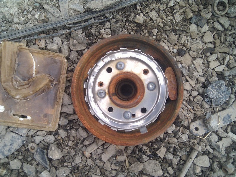

I was at the wreckers today and came across a VN balancer on the ground. I got some pics, so if considering using VN/VP commodore coil packs you can get an idea of what your going to need to do.
Obviously this one was a bit bent and knocked around when it was removed.

I drew this from the manual.
Shouldn't be too hard to make make two flat trigger wheels like this:
crank trigger.pdf
mount them with some form of spacer between them and then use the V6 crank angle sensor on it's side.

I've been looking at making a flat version of the interupter rings shown above and bolting them to the front of the harmonic balancer. I may be able to mount the hall effect switch between the harmonic balancer and altenator. This will keep it away from the drive belt.
Does anyone have any experiance doing this? Can anyone see any potential issues with this?

The system uses a trigger wheel, a double Hall Effect pick up, the DIS and the ECM. The trigger
wheel has 2 interrupter rings, 1 with 3 interrupts the other with 18, the 18 interrupt is a high
resolution RPM signal generator used by both the DIS and the ECM to adjust timing angle.
The signal is conditioned by a divide by 6 circuit and then output to the ECM. The 3 interrupt is
the timing control signal used only by the DIS, all 3 interrupts are of varying length to allow the
system to accurately fire the engine, and the official blurb is the correct plug will fire within
60° of rotation.

Simulating the 18x signal would be easy, the 3x would take a bit more with out using logic.
Sycning the pulses shouldn't be that hard..
Making the trigger wheel after looking at the pic from charlie86 seems straight forward
give the drawing to a lazer cutter :) just need enough room for the pickups - prox's would be better
