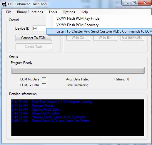

The faults 16 and 55 are related to the analog 5v reference. Code 51 is a checksum error and i doubt its current. Might need to reset the fault codes and see what new ones happen. In the flashtool you can send a custom command f4,56,10 (click the calculate checksum box) and it will reset them or just remove the battery or EFI fuse for 30 seconds and will do the same job.

I may have an old version of Flashtool because I can't see anywhere to send custom commands, calculate checksum included. I'm not plugged into the car at the moment so could that be the reason or should that function be available even when no going RT?
Re: What to monitor/ adjust in RT?
you just not looking hard enough
Lol! Seems to be the story of my life ffsJayme wrote:you just not looking hard enough
