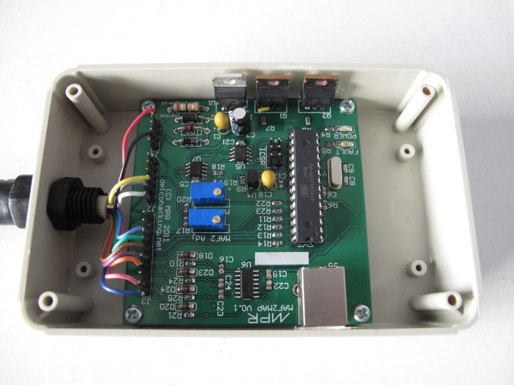

Anyway, before finding out the clamp read wrong I made this little device up...
It takes the 0-5v MAF signal and can modify the output +-50%. Also has a few other inputs to make it more tunable - RPM, VSS, Inj DC, TPS and wideband. It has USB for logging and uses TunerPro to edit and log with. Am still playing with the firmware but its getting there slowly. Its happy making changes to the MAF voltage, car runs identical with 0% adjustment and no CEL :thumbup:

Just had a close look at pcb and is shows maf2map should have looked first.

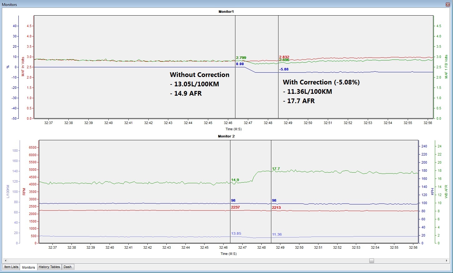

Am only making small changes to gain some fuel economy at cruise speeds (seeing a nice lean cruise AFR of 17 instead of 14.5 now). All the high load stuff is being left alone for the reasons you mentioned, its changing airflow/load and not just injector rate for fuel 8-)

Here is an example of a -5% change of the MAF voltage - so MAF volts in to the adjuster is 2.832v and the output is 2.696v. With a slightly modified antus OSEplugin it does RT changes. At a steady speed while on cruise and on a flat road just hit the current cell (data tracing) with -5% for instant change....

Does it have a frequency to voltage convertor so you can connect it to a maf that outputs frequency.
