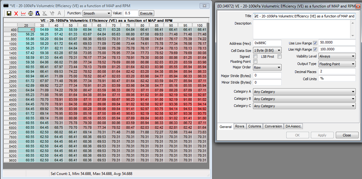

Yes I dont think you can select colours (green to red seems more natural han aqua to red), but you can colourise the table by turning on use high range and use low range and setting them to the limits of the colour range your after. If the colours arnt clear enough at the min and max allowable values then you can set them to a more narrow range and you can still edit outside of that range. Eg for VE you might set "use low range" to 50, and "use high range" to 100, and should you need a value of 40 can still be entered.. see here in the 20kpa/400rpm cell.
tp5 coloured cells.png (176.62 KiB) Viewed 3874 times

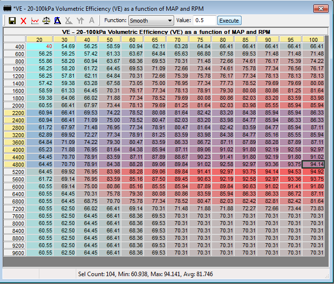

If 'smooth between boundaries' you mean smooth a selection, then yes you can select the area you want and smooth it.
smoothing a range.png (95.37 KiB) Viewed 3874 times

Oh Cool Thanks Antus, had noticed the smooth range in selection tool up the top but hadn't tried it, with the boundaries yeah it's just like the slection you have chosen there & then smoothed.
I know previously when I've tried the hi low range it's showed items out of those ranges, but if you save the edited items out of the boundary next time you open it, it was just saved as the max hi limit, but again I haven't tried it for the last year or so as I knew it was an issue & may have been fixed?
Posts: 9018
Re: Creating a good VE or Inj Mul Table
Your right, it still does that. I'll report it to Mark. Probably nobody has noticed and told him.
